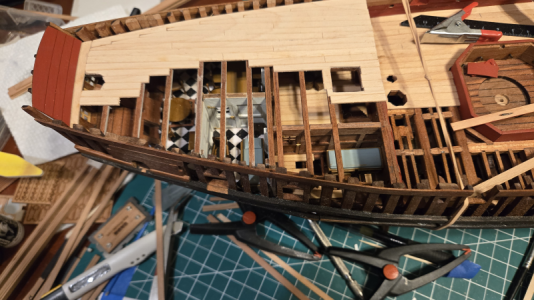

Time to install the remaining forecastle beams. Sometimes it takes me a bit of fiddling to to hold pieces in place while the glue dries:
The included waterway was a rather poor fit on my model. No doubt due to mistakes I have made in shaping the bow:
I was able to reshape it to a reasonable fit:
I decided not to raise the waterway on the foredeck (and quarterdeck for that matter) like I did on the main deck. On the main deck, the waterway is specifically raised, with outlet ports along the deck (not shown on any source I've seen except models), because otherwise water would accumulate on the deck. Both the foredeck and quarterdeck have enough slope to take water to the main deck, so I felt this detail was unnecessary.

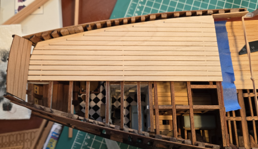

Decking is progressing on the foredeck:

I planked over a bit more of the foredeck but apparently didn't photograph it. You'll see it later.

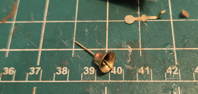

I went with the L-shaped hinges rather than the cast ones, as I saw no way of mounting those hinges, nor bending the brass strip around them, and have it come out decent. These hinges may look upside-down at the top of the doors to you. They do to me, but I reasoned that these are removable panels, and the doors should have to be unmounted quickly, so hinge pins pointing in the same direction would allow for this. The instructions showed locks with only the end of a brass nail as a "knob", but this looked undersize to me, so added the small brass circles (hope I have enough later for whatever they're to be used for). And just added these circles on the side of the door opposite the latch to simulate a knob only.
Here I've added a hatch surround simulating the hatch to the breadroom below. The Cap'n made sure fabric was added over this hatch as well, matching the floor:
After addition of a couple rings on the breadroom hatch, and a two of the quarterdeck cross beams which help to locate and retain the walls, we have:

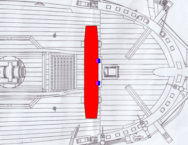

I need a bit of advice here. Skipping ahead from other things I've done since the last post, I was going to add the mast coat to the mainmast. As shown by the instruction below, the main mast is a 12mm diameter dowel:
This is confirmed because it is a nice snug fit on the template shown in blue above.

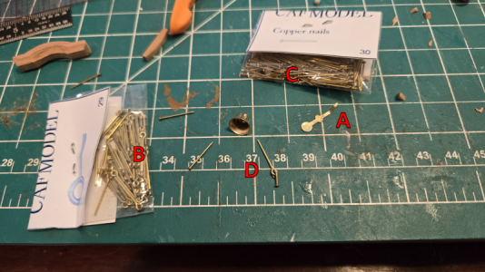

I decided to work on the Belfry. The small brass bell included is nice, but the piece included for the ringer (?), uh, isn't. It didn't really work as a ringer, or support, or anything, really, so I used a ring and nail instead:
A is the included "ringer". B are the rings and C are the nails, put together to make a ringer and bell support D.
The result is much better, and looks pretty good from the side, where you can't see the ring:

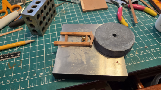

I then mounted the bell onto the bell pivot (the extension of the ring acts as a lever), and assembled it with the top:
The bell pivot actually "rings", using small nails as a pivot. I used a temporary spacer at the bottom to keep the vertical arms parallel. I also placed shims under each arm to center the top piece , which is wider, then weighted it while glue dried. BTW, the two vertical arms are different length because one side will sit on the main deck, while the other will extend through the deck structure to the beam below.
I was concerned it would be too flimsy, but ended up fairly strong, if not manhandled. I dropped it a couple times, of course, but it survived.
I then checked the fit in the required location, and found a problem:
There isn't room for the belfry to fit between the foredeck and the windlass shaft. Okay, what have I done wrong now? I knew from doing the foredeck planking that it was a bit long, compared to the plans, but it was all based on the windlass support, so still should have been okay for the belfry.
Taking the plans, I determined that they do indeed indicate an problem interference at this location:
In blue is the belfry uprights, red is the windlass shaft (rotated to its maximum width) and magenta is the interference. Same in below:
So, I checked out Goodwin's side cross section:
It appears that the windlass should have been further aft, or the foredeck further forward, creating clearance rather than interference.

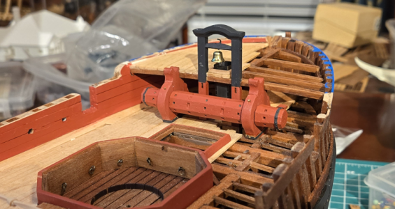

I decided to fix the problem by moving the belfry forward into the foredeck by notching the uprights to clear the foredeck cross beam and deck:
This isn't realistic, of course, because this would severely weaken the uprights, and we wouldn't want to cut into the crossbeam. But it should look okay, and be far preferred to rebuilding everything.
After mounting the belfry as well as the windlass assembly, we have:
And while there is very little clearance between the windlass shaft and the belfry uprights, there is at least some:

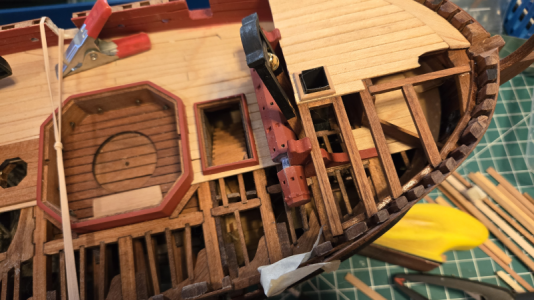

Continuing, I added a piece of inner planking to the forecastle, which will help support the planksheer at the forecastle.
It will taper from little to almost nothing - I think my decks in general are a bit too high - but it will be seen somewhat.
Here I've started adding crossbeams for the quarterdeck, add included a couple carlings around the rudder head and tiller housing.

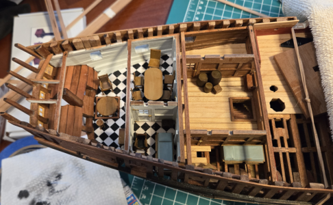

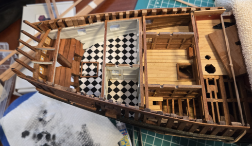

I decided to add a minimum of furniture to the cabins: a chair, writing desk and bunk in the Captain's berth and Master's cabin, table and chairs in the Captain's Day Cabin and dining table and chairs in the Dining Room. I'm attempting to hit that in-between level of detail, where I care enough to include the bare minimum of furniture, but don't attempt to compete wih far nicer builds that include charts and silverware. You know: "He cares about detail, but isn't that great at it."
My intent was to include hammocks somewhere, and even spent months developing some good looking ones, but realized there aren't really any place to hang them except in the 3 larger cabins big enough for bunks. The small forward cabins don't even have room for them. I am amazed that a crew of 60 men could be accommodated when sailed as a bomb vessel (double or so as a ketch). Where would they sleep? Probably curled up into corners, nooks and crannies, wherever they could find room, using other crew members for warmth. What a life! :eek:
With the minimal furniture in place, the remaining forecastle deck beams were added:
Those in the Captain's area were painted white along with the ceiling and walls to lighten the area.
Next would come quarterdeck decking. The included decking material ended up too short for my ship:
The outboard planks would not reach the after corner of the quarterdeck. Neither would the waterway.
I decided to add a small "waterway" made of scrap at the stern, thus allowing for shorter planking, then began planking:
Here all planking desired has been added, with openings for the rudder head and hatchway:
I wanted to show as much deck as possible consistent with still giving of the aft quarters and furniture.
