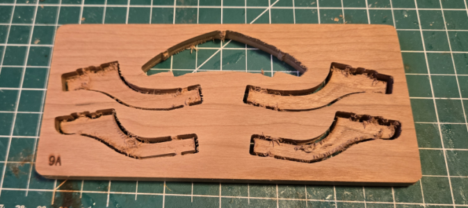

Hello, I have seen your comment and thank you very much for your feedback on the product。
For most laser processed parts, I have added a margin of 0.2-0.3mm for polishing off carbon black。
But for a 1.5-thick deck, theoretically adding a margin of 0.1mm is sufficient, but considering the different production methods or errors of each person, increasing the width of the deck will make up for the problem. After all, it's much better to polish with margin than to leave gaps without margin。This is my little insight。

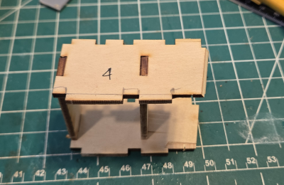

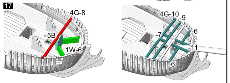

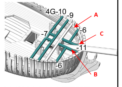

After doing all the main deck structure and reinforcements, I needed to then place these parts properly to support the forecastle deck:
This is for proper location of the forecastle cross beams (below) and breathook (red part 4G-13) above. This is from a future instruction.
Note that the cross beam supports (A above) and longitudinal supports (B above) either side of the bowsprit clearly sit atop the breasthook (C above).

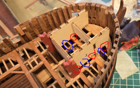

I first assembled the template and then tried to place it in position:
It doesn't fit. There are notches to go over the main deck beams (circled in red above), and between the notches the template is extended. But the carlings, installed in previous pages in the instructions, prevent this. Not wanting to remove the already installed carlings, I instead decided to modify the template:
On the left below is the original shape, with beam notches marked, and on the right is as modified:

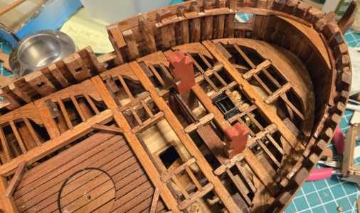

After modification, the template fits in the proper location, and the markings to locate the beams can confirm this:
On my model, the breasthook ended up a distance away from the fore structure, so I added small supports, at exactly the same height, to help position it:
This holds the breasthook in place better.

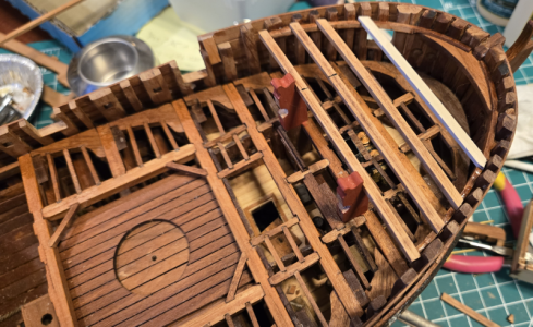

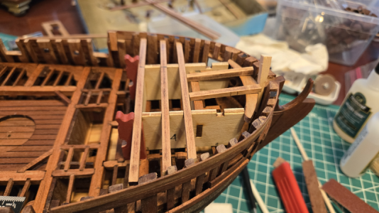

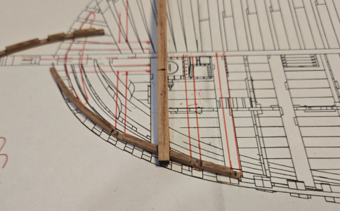

Since the 4G-6 crossbeam is in 2 pieces, and I wanted to confirm proper beam locations prior to attaching it, I made a single piece temporary replacement for the split beam from 2 pieces of thinner 4mm wide stock glued together, and formed using the other cross pieces to obtain the correct curvature:

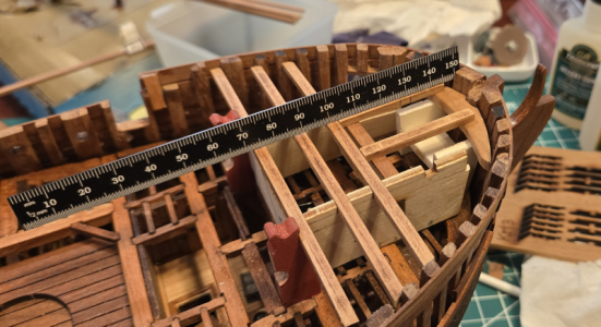

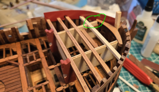

Using all these beams in place to check forecastle alignment I have:
Notice here that the beams are in line horizontally and very close to top of the breasthook. But something's wrong - the longitudinal beams are supposed to end up flush with the cross beams and SIT ON the breasthook, per the second diagram above. That can't be, as shown below:
I also took a piece of red cardboard and located the bottom of it to match beam support pieces 3D-3, marking the beam locations, and put it into place:
The bottom of the cardboard template, and therefore the support pieces 3D-3 cannot possibly fit on top of the breasthook.
After checking the kit's plans (very hard to locate the breasthook in the side cross section), as well as Goodwin's plans, I realized that the breasthook cannot possibly be located at the height determined by the template. Not only do the pieces mentioned above not fit atop it in that position, but I think the bowsprit would hit it when located.
I'll stop right here while I try to locate the bowsprit position to confirm this.

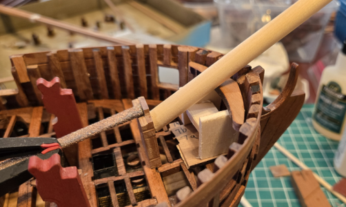

Looking at the plans, and roughing through the location, it was looking like the bowsprit would hit the breasthook:
I made the small H-shaped piece above to support the breasthook to what I /thought/ would be the correct height, about 2-3mm lower than the included template showed. Here I included a small shim to bring it to the original height, confirming the bowsprit would hit.

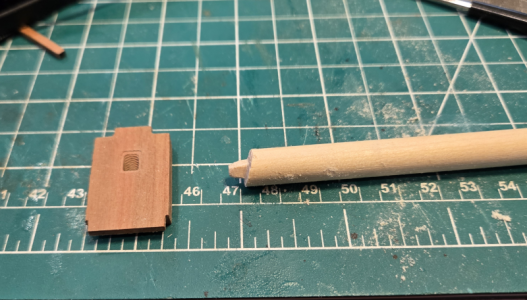

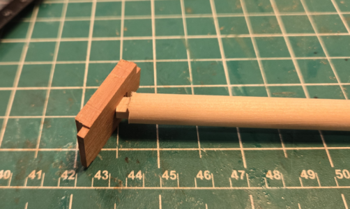

To be sure. So, time to fit the bowsprit to the bowsprit support piece:
The end of the bowsprit must be shaped to fit into the roughly rectangular hole in 5B above. I marked the approximate size on the end of the bowsprit:
(Note that 5B above shows it being installed atop the planking, but it needs to fit between the main deck beams, so that might be much harder to do. I intend to mount this piece /before/ planking, so it can be sturdier and fit properly.)
The size of the projection should be roughly 3mm x 4mm but varies quite a bit. Nevertheless, I wanted to start out with a projection that would approximate the correct size, then sand to fit. I needed a way to cut the rectangular projection centered and rectangular, not angled like a parallelogram:

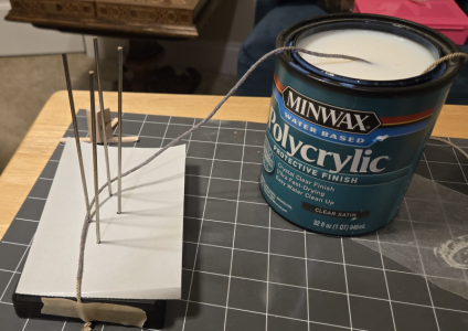

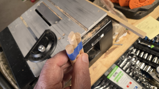

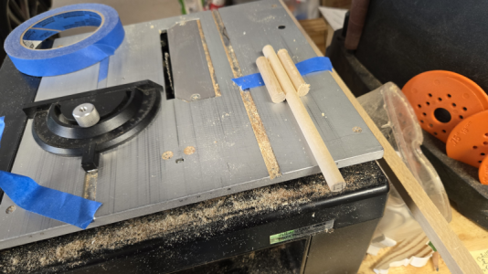

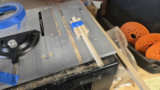

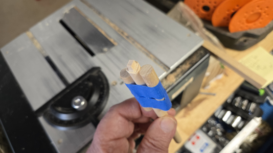

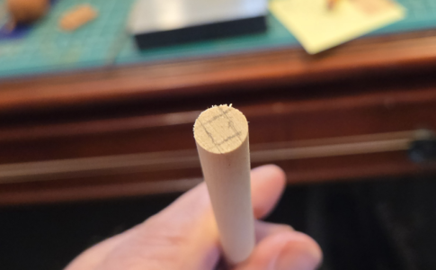

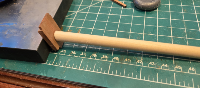

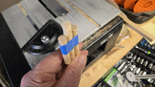

The method I devised to create the approximate rectangular projection was to use a table saw from either side to remove material, while using dowels taped to either side of the bowsprit to maintain it horizontal and vertical position:
I set the dowel at an angle of about 18 degrees, which approximates the angle between the bowsprit and the bowsprit mount, per the plans.
Then I removed the tape, turned the bowsprit 90 degrees, and went again, cutting from the opposite angle.
And ended up with a roughly rectangular protrusion:
Just having a rectangular protrusion, even at the correct angle, doesn't make it fit the unusually shaped hole in the mount:
Trimming with trial and error, I eventually made the 2 pieces fit acceptably:

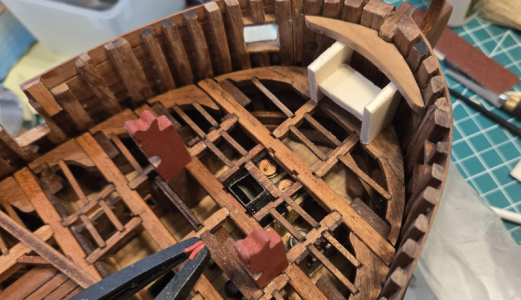

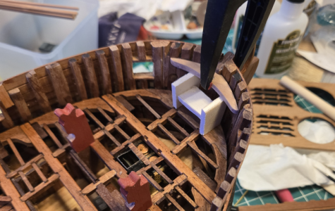

With the lower height of the breasthook, I removed the shim and positioned the breasthook in place:
Then added the template and positioned the cross beams, as well as the extensions:
They fit perfectly onto the new breasthook location. I'll have to make new extension pieces out of scrap, as these aren't long enough. But I'm convinced I now have the correct location and height. I've rounded the top of the breasthook very slightly to match the curvature of the cross beams and deck.
Finally, I glued the breasthook in place using my modified template:
The bowsprit now misses the breasthook and the breasthook now establishes the forecastle beam level. I'll have to see where the side beam supports end up; I imagine I'll have to trim them a bit to get the right height at the front, but that's fine.

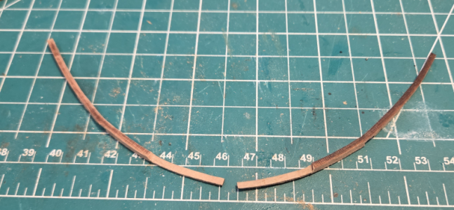

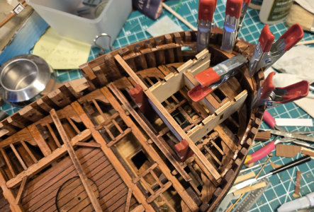

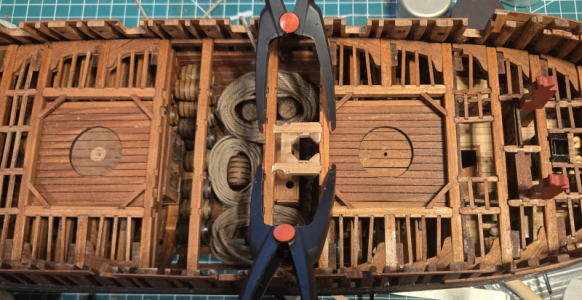

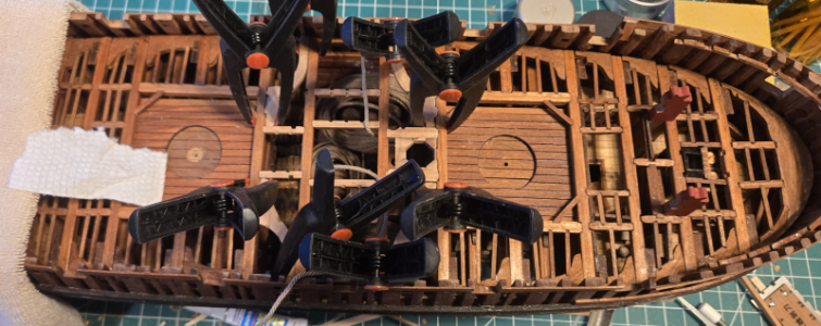

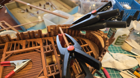

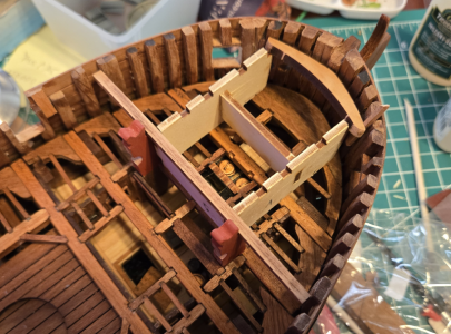

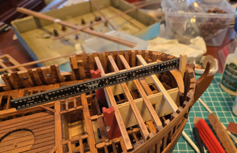

Continuing on with the forecastle support beams, I need to add the support members for them on either side. From drawing in Goodwin's book, I think I still have the breasthook higher than it should be (but lower than what the instructions indicated). But I like it at the height it is because it directly supports 2 longitudinal deck beams, and also the side supports.
I started by bending the curved supports for the forecastle support beams by moistening with water, and then using a plank bender. I've never been good at this. Usually they break. These didn't break, but didn't get bent as well as I'd hoped. But I got them pretty close. To help them form in place, as well as hopefully keep them from breaking when mounting, I soaked them briefly in water (too long and they straighten back out), and clamped them roughly in place, to the required curvature:

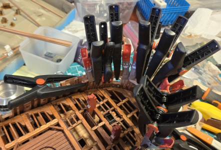

We all love our clamps, don't we?
I marked where these supports met the breasthook that they would rest upon, because IMHO they needed to be about half their thickness in order to mount directly on the breasthook. Here's the curved supports with thickness at ends reduced:
I also used a copy of the kit plans to confirm location of the slots for the cross beams, and widened them somewhat (much easier to do before mounting):
Rather than measure the location of the supports, I used the template to position the beams, one at a time. I started with the aftmost cross beam, and by trial and error, locating the correct position for the one beam, and approximate position toward the bow:
I took this photo after doing it with the beam mounted only to the windlass supports; I came back later and used the template, hoping the location would be the same. It was.
The idea here was not to try to locate the entire beam - I've had lots of problems doing that. I made it fit into only the first beam properly, clamped the rest in approximately the correct location, and CA glued only at the first beam.
I continued along, moving as required for each beam, clamping in place, and CA gluing a bit more, working toward the bow. I once again used my substitute beam to locate for the split one.
After everything was aligned and glued I removed the cross members until later in the process:
I stained the support on the starboard side, as CA glue will prevent stain from going on evenly, and it will be somewhat visible. I didn't bother on the port side, as it will be covered by decking.
I used quite a round-a-bout method to do this, making small changes in the process, but by doing that I feel confident that things are in the right place and should not cause any problems. That's a win, for me.

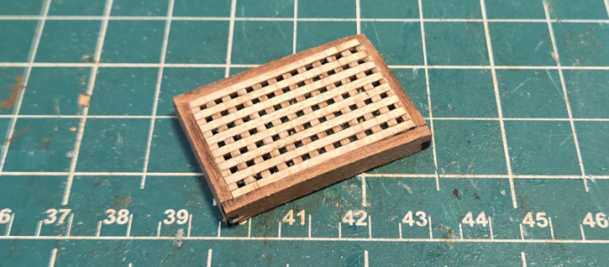

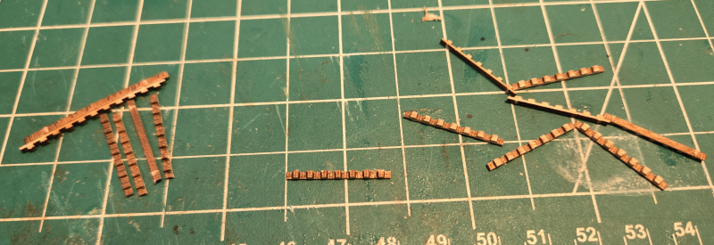

While working up the courage do the mortar surrounds, I decided instead to work on the two hatches for the main deck. The main hatchway is covered by four removable planks, one of which is notched for the anchor cables. The fore access hatch has removable grating on it. The reason I was going to work on these now is that per Goodwin they are mounted on the cross beams and structure, with the decking butting into them. But those with the kit are instead mounted atop the decking. And are a bit too low. But close enough, I decided to build them as provided.

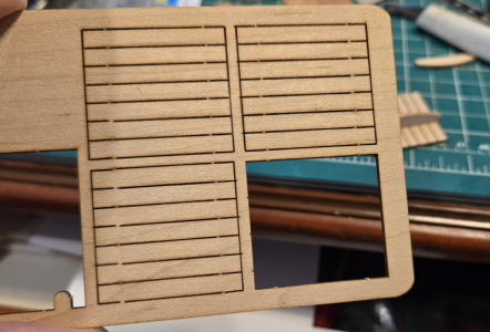

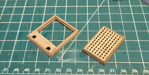

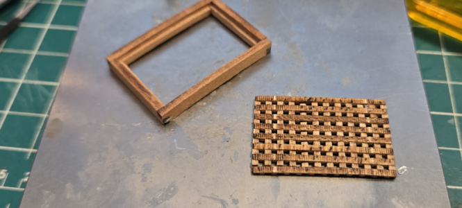

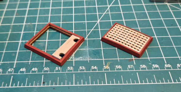

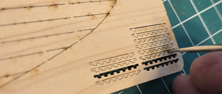

Nothing unusual about removal of the laser cut pieces for the grating, but I want to point out that complex parts like this are far easier to remove when pushed out from the back toward the front of the sheet. The laser cut is wider on the front, so the parts don't wedge and tend to break:

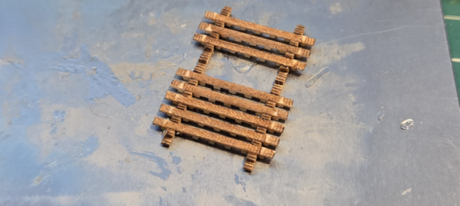

In pre-assembly of the gratings, it appeared that unless each notch were filed or sanded, deepening them a bit, that the raised surfaces of the lower pieces would end up slightly lower than the raised pieces. Being too lazy to modify all the slots (and afraid of breaking them as well), I sanded the tops of the pieces slightly:
Those on the right have been sanded.
Assembly was the standard ladder method. I'd mount a couple and CA glue them from the back then continue. They need pressed snuggly in place:
These pieces are not as precise and don't fit quite as well as the milled pieces included with most kits, but they can be made curved, as these are, and the result is fine:
A little sanding on the edges, then sanding the top yields:
The coaming around the hatches should be tapered towards the top, per Goodwin, and slightly higher than these by about 1mm, but I just tapered them
And after a coat of Red Oxide paint, they're almost done:
I'll add the rings to the main hatch boards and finish them all later, along with the decking.

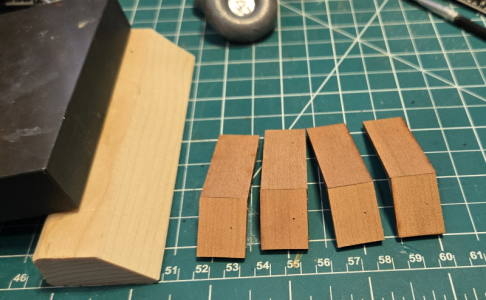

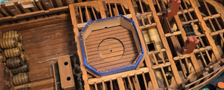

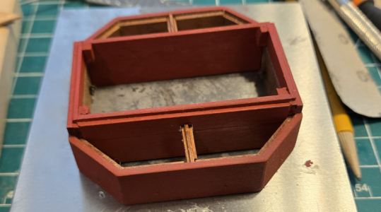

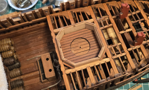

Ready for another of Signet's "Ignore the Instructions and Do It Your Own Way?" Well, welcome! I'd been avoiding making the 8-sided (turns out is IS octagonal, just not a regular octagonal) surrounds for the two ship mortars. CAF gives you a neat template of the correct shape, but my concerns were: 1) Not being able to see the inner surface, I'd get glue all over it, making a mess, 2) the glue would stick the structure to the template, and I'd damage in getting it off, 3) Even if the glue didn't stick, if it's a tight fit, it would be hard to get off without breaking.

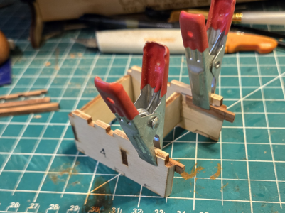

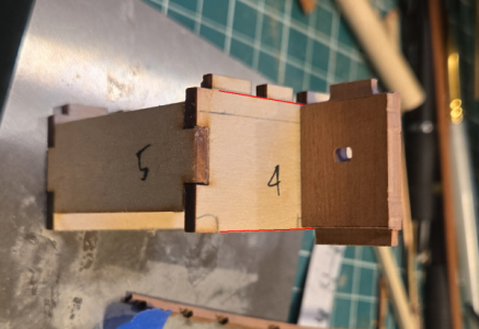

The first thing I did was to take the assembled side pieces (1 and 2 mm thick pieces) place them into the octagonal framed area on all sides of the template. They didn't fit. Which meant, in my case, I had to reduce the outer size of the template. So I sanded until I got everything to fit in place.
I was still worried about my 3 points above, so thought if I made 4 mini-assemblies, that would be half the gluing to the template. So, after assembly of each pair of pieces, and sanding all edges to 22.5 degrees off of vertical, I tried assembling a pair:

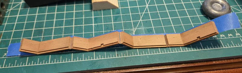

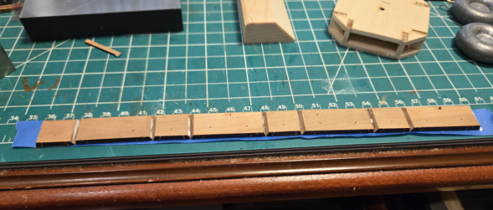

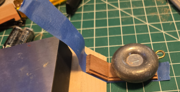

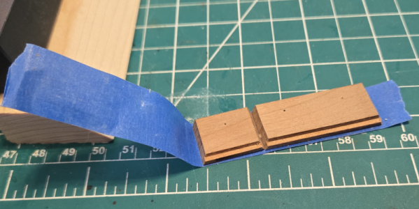

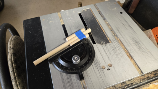

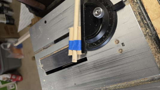

Here I'm using a method I'd used previously on small parts, to insure a tight miter fit: simply stick each part onto some masking tape (or in my case, painter's tape), but the two closely together, add some glue to the notch, and bend and position:
I actually made the first pair by making the tape long enough to fasten back on itself, making a triangle, but was concerned I'd over- or under-tighten the angle, so cut a small board at the required 45 degrees:
So, at least half of my joints would be tight. At this point, my plan was to place each assembly around the template, and glue in place using the template, while adjusting the length of each by sanding the ends to get a good fit.
The resulting 4 mini-assemblies:
And checking that they all fit into the mortar area:

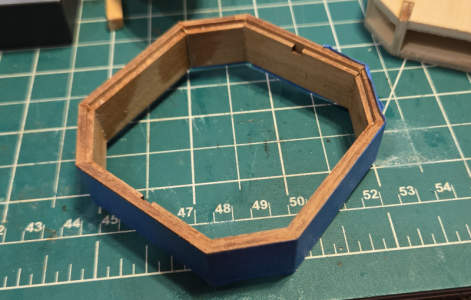

After doing that, I couldn't help myself, I added all the pieces to a single length of tape:
and connected the ends to make the full shape, without glue:
As it turns out, it all fits together fine, but is too small to go over the template. Perhaps I'd sanded a bit too much? But it fit okay into the opening:

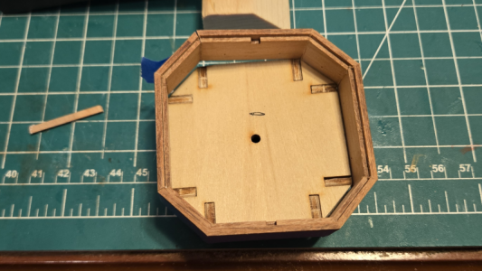

Here it's upside down, to use the finished edge to fit squarely on the mortar bed. This looked fine to me, so on the next one, I took a slightly bigger step, not using the mini-assemblies:
It's important to align each piece with the neighboring one. I straightedge helps. I tried to keep the reference edge off of the tape, and snug against its neighbor. A bit of glue is then added prior to bending:
After "bending" the assembly, and connecting the ends with tape, we have a pretty decent octagonal assembly:
And that's just holding it in my fingers, no square, no template just tape!
Each of the assemblies easily fit into the openings, which is a bit surprising because when using the template it was too tight, but now it fit!?

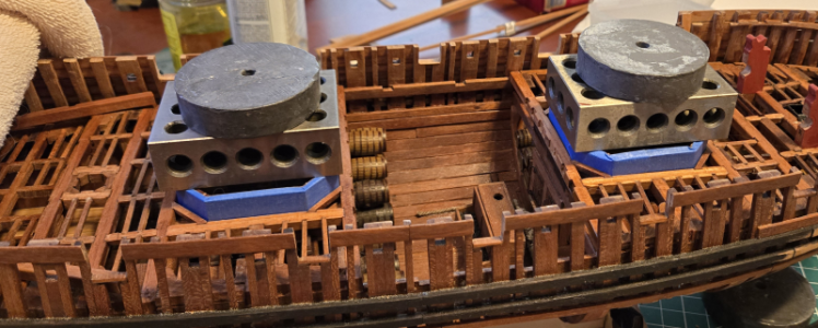

Here I was letting the assembly glue harden, while keeping it forced against the flat mortar beds. Again, upside down, to insure a flat surface.

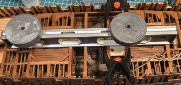

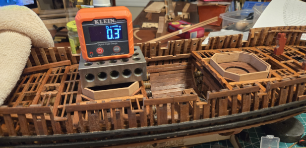

After the glue dried, I placed each assembly in place and checked the level (per Goodwin, they are to be level even if the deck around them is not):
Close enough for government (and my) work. And they fit well into the openings, with just a bit of clearance. I'll glue in place them once they're finished.

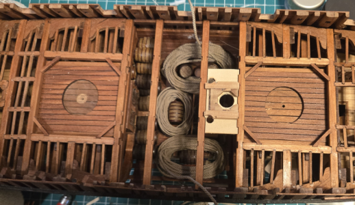

I added the turning rings to the sides. I added four, for a total of 12, to space them closely. In retrospect, probably shouldn't have, but it's not bad.
After painting the housing Red Oxide, I set them aside for later. Now to work on the housing that fits into them.

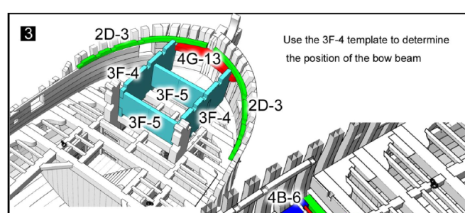

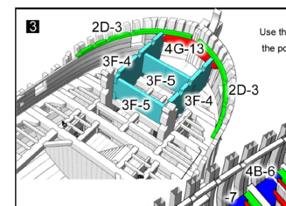

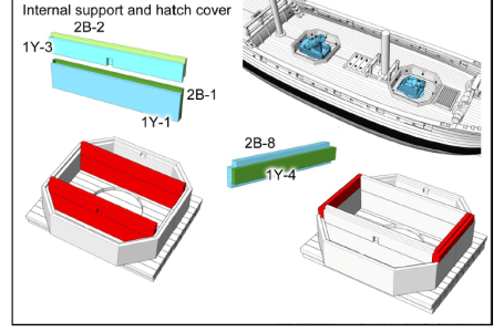

Concerning those parts, here's the instruction illustrations:
They don't say whether to glue the lower and upper assemblies together. I know on the original, these are all separate pieces. But I feel that it would be easier to work with if glued together. My intent is, like many of these kits, to show one mortar completely open with everything removed, and the other partially visible with most of these structures in place, as they are all very interesting. But I don't think I want to keep the pieces all separate, where they'd fall apart (I don't see any guides or anything to hold them in place even).
These pieces take up a lot of room, and I would imagine that prior to battle, they would all be removed on moved onto the tender that usually accompanies bomb vessels. So I'm considering gluing the side and end pieces together, in order to be able to remove or insert them all as an assembly, held in place by the structure, rather than being separate pieces. I'd appreciate any thoughts or ideas concerning this.

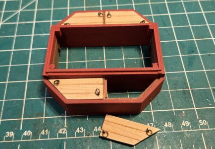

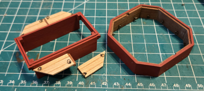

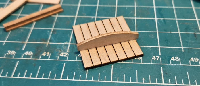

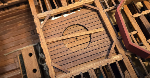

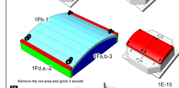

I decided to next work on the structure that protects the mortars when they are not in use. I started with the sliding hatches, as I wanted to be sure that the members the hatches slide over are spaced properly. The instructions show this part:
The referenced parts 1Fh-1 are here:
But when comparing the hatch cover parts versus the width of the hatch, it's obvious they aren't wide enough:
In fact, the instructions show 8 boards in use for the cover, but only 7 are included. I was going to cut 4 extra from the scrap, until I remembered that I only intend to show this structure on one mortar, rather than both, so just took an extra board for each cover.

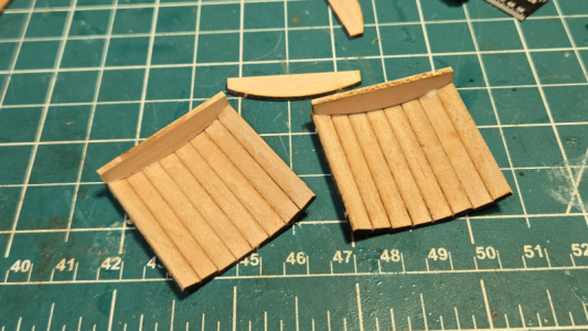

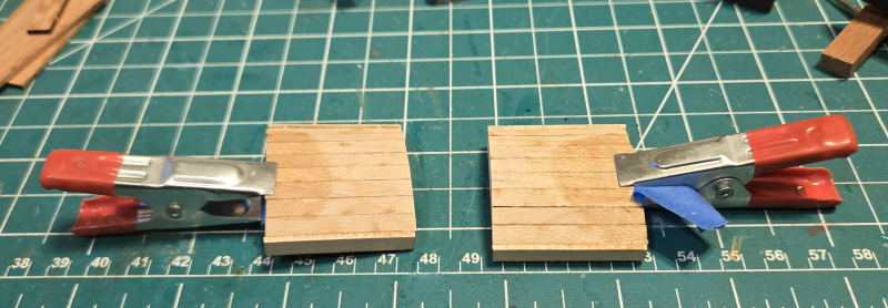

After sanding the edges of the planks, including a slight bevel on the side that will be the bottom, I used my patented painter's tape method to attach the parts:

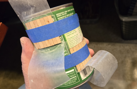

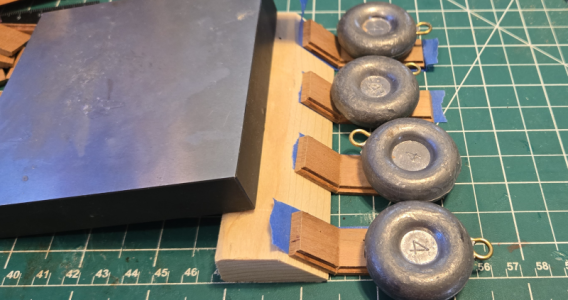

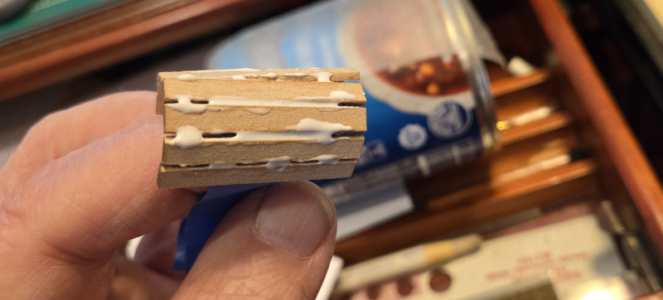

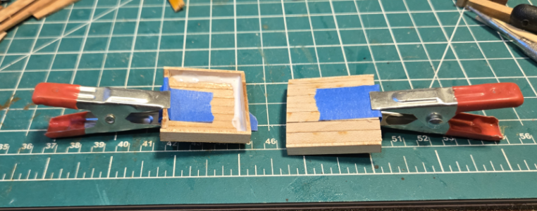

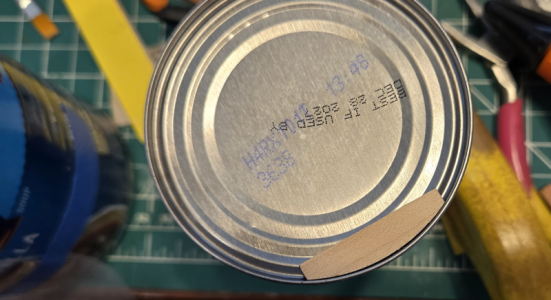

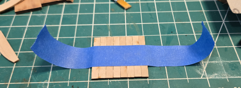

I checked the curvature of the end of the cover and selected a canned corn can for my use:
And taped the planks onto the can to create the curve:
Although it measured fine, the curvature tightened up a bit after it dried, so I probably should have used the slightly larger Progresso Chicken Tortilla Soup can. But I'll make it work.
I used the extra ends from the other mortar to help maintain the curvature while the glue dried. I put ample glue around the edges to strengthen it.
I found that the end with the end cover maintained spacing and curvature well, but the other unsupported end wanted to bend it be more, narrowing it somewhat. So I clamped the other ends in place and wet the white glue some to soften it and help make it the correct curvature.

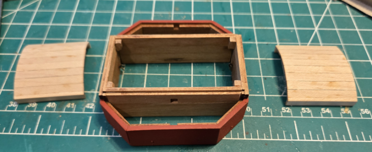

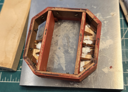

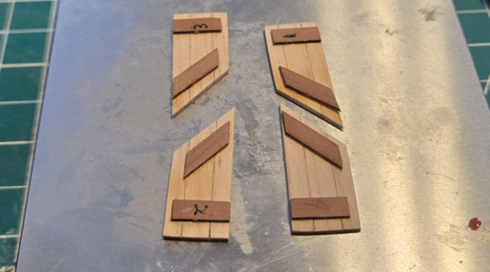

Before continuing with this mount, I noticed I could see the top of the L-shaped brackets below the mortar supports on each side, and they created a gap with the mortar surround. This was because my planking ended up above the top of the L-shaped bracket. So I filled in those areas a bit to eliminate the gap:

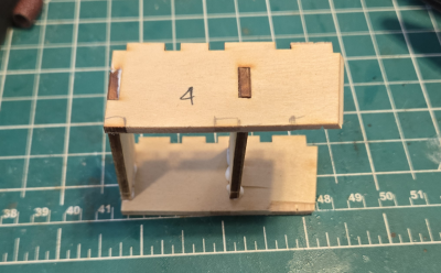

I placed the removable parts within the mortar surround, and glued these four parts together, adding small blocks in the corner for strength. Notice I did /not/ glue any of these parts to the mortar surround - I wanted to be able to remove the assembly to show the mortar in firing position:
And I wanted to be able to remove just a single assembly to do this. So these added parts had to be an easy slip fit into the octagonal surround, yet glued to the removable parts. This isn't, of course, the way the parts were handled on the original ship. Each part was removable, to ease the assembly/disassembly and lesson the weight and space each part takes. But I have no intention of displaying it as separate parts, only as a complete assembly or as the mortar surround only.
I then added the small cover supports, gluing them to the removable structure only:

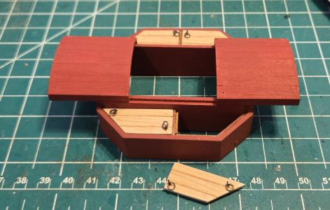

I then made and fit all the covers in place, for a slip fit:
As I believe they would have been in real life, I added cross-supports to strengthen the covers, and (on the original) to keep the boards connected. Then added eyebolts and rings.
This upside down view shows 3 of the 4 covers in place, as well as gussets to securely support them, all glued to the removable section. None of this glue will show, of course:
I added a messy amount of glue to insure the assembly would remain one piece during and after removal.
The completed removable supports and covers will look like this. I'm leaving one cover loose to show storage areas when mortar is not in use:
I will add the rings to the covers later, after another coat of paint. Without the covers, it looks like this:

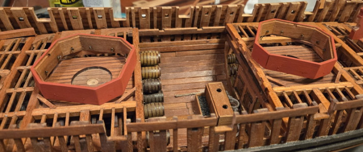

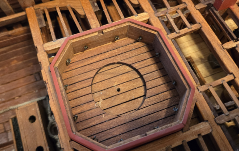

And finally, with the entire assembly removed, we see the mortar in combat configuration:
This removable area will either be left in place, to show these parts when mortar is not being fired, or hidden away if I decide to not include it, as it does not represent the separate pieces that it would when normally removed. But this makes it much sturdier, and easier to switch out.

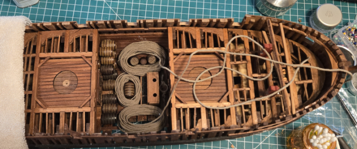

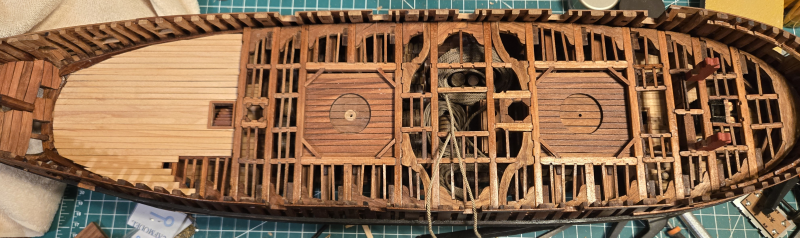

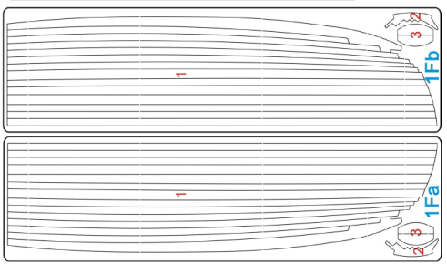

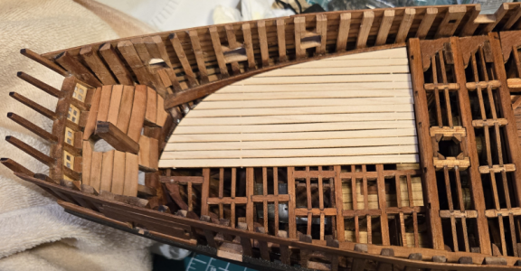

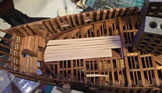

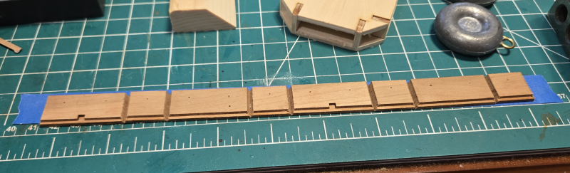

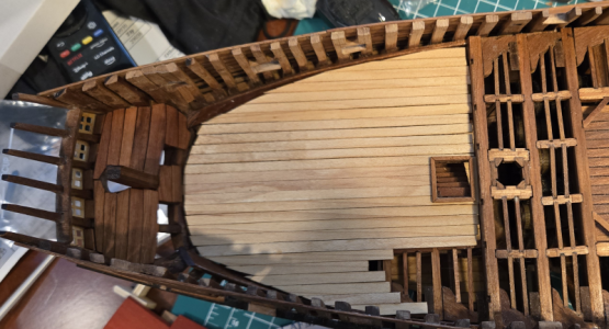

I've decided to plank the aft deck under the quarterdeck next. The planks for this are precut, but don't follow my required area very well:
While the curve to them is nice, my structure isn't that shape. And unfortunately, they don't have any extra length on them. And like all the planking, they require sanding the edges to get them the correct width (about 0.5mm is added per plank x 12 means it's over-width by about 6mm, probably more). IMHO, these would really be easier to do using just 5mm planks, as each piece has to be sanded, and then shaped at the end. Some 1.5x5mm strips were included, but I have no idea where I might need them, and I'm certain there aren't enough to do all the areas with strips.
In trying to use as many of the area's planking as possible, I inserted 3x1.5 strips at the center, then intend to use modified area planks for the rest:
Even after sanding, the laser-cut planks have gaps that the strips do no. I'm not that pleased with the result, but it will be pretty well covered by the deck above.
I left only a small area without decking, to give an impression of the deck and framing below. I'd do more, but the captain's deck will be much more visible, so I'll concentrate more on that.
Again, this doesn't look very good, but will be almost entirely covered. I didn't cut out for the aft hatch to the bread room, as I don't intend for it to be left open.
Looks good, but providing laser cut deck planking doesn't make sense to me??
I would have expected a kit of this quality, to provide strips of the appropriate width. This would allow you to cut and shape them to the proper deck curve, as well as add butt joints, etc.
Removing the laser char will always result in uneven planking, resulting from the slightly different char thickness, as the density of the wood changes.
If you have any spare wood, milling your own planks might be worthwhile, especially for the fully visible decks above.
I'm in complete agreement here. As to a "kit of this quality", I'm sure CAF has provided the laser cut planking in this high quality kit at greater expense, in the hope it will help modelers to create the correct shapes. Some light-colored wood strips 5mm wide are provided for this purpose, but I'm sure not enough to use them everywhere. I assume many modelers prefer the laser cut decking, but I find that even if they fit correctly, they require more work, and if they don't fit, then that's twice the trouble.
Perhaps printed paper sheets of the required decking areas, like the one above, would give good information concerning the shapes, and allow users to use 5mm strips instead. Now, in the case of the main deck planking below, the curves and widths vary over the length of the deck, and I'm sure that the laser-cut pieces will be greatly appreciated:
This would be difficult or impossible to achieve with constant width strips. So there is definitely a place for this, but maybe not for simpler/straight planking.

According to Peter Goodwin's book, the Granado probably carried five anchors (three bower, one stream and one kedge). Generally, a ship of this size carried six cables, all 120 fathoms in length, five of them 13in circumference (2 for the bower anchors and three spare), and an 8in circumference for the kedge anchor. The two bower anchors were secured at all time to their respective cables, ready for instant use. A third bower, or sheet, anchor was secured abaft the starboard bower, free if its cable. The stream anchor was stored below, while the kedge anchor was lashed to the spare bower.
I intend to model the 2 bower anchors in place with their cables, and the sheet and kedge anchors. I'm uncertain about the stream anchor, as I'm not sure it could be placed below deck going through the largest opening, the main hold hatch.
I also intend to model the 2 bower anchor cables (2.2mm in diameter), as well as the kedge anchor cable (1.3mm in diameter), each of these 120 scale fathoms long (720' or 15 actual feet on the model). These will go into the main hold, where they belong. While it is possible the spare cables could go under the ones in use, what with the necessary access to the bombs stored under the mortar structure, they would severely limit access. I am therefore making the assumption that spare cables, and probably a lot of other equipment (like the mortar covers during shelling) would be kept on, or transferred to, the tender ship that accompanied the Granado and other British bomb vessels.

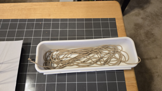

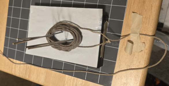

My problem, as well as my delay, in adding the cables is how to make them look reasonably authentic, and keep them in place during the rest of the build and afterwards. I experimented with white glue, and didn't like that. I bought some scenic cement (white glue and water mixture) commonly used by model railroader on ballast and such, and it didn't hold well at all. I didn't want to use an oil-based varnish, because of the mess and cleanup I knew would be required. I tried an water-based wipe-on poly, and it, surprisingly, didn't hold either. I finally arrived at Minwax Water-based Polycrylic. And it didn't change the cable color toooo much - maybe it just looks welt. Not great, but the best I found. I also found that simply coating a coiled rope with it didn't hold enough. It needed to be doused. Here is the story of my method:

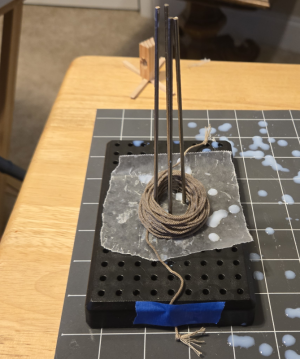

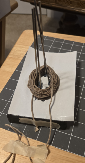

I started out with plastic base that came with alligator clip sticks, and used the sticks to roughly position the cable:
(My intent was to pour the Polycrylic into the tray, but I decided to take another route.) You may notice I used Left-Lay rope to simulate the cables, where were 3 strands of right-lay rope would be would left-layed. I used the cable-lay (left-lay) ropes rather than actual model cables due to the cost. Cables would cost 30 times as much as rope, and were not available long enough from my supplier. I did buy sufficient cables for display on-deck, but I may prefer to keep the anchor ropes in one piece, in preference to splitting them.
Here, I've committed myself, by dousing all of the first rope into the can of varnish. No going back now!
I've taped the ends of the rope to the can so as not to douse the last 18" or so for connection above deck, and to the base to hold it in place.
I tried to make the first few rows flat on the base, properly (tightly) coiled. I was using the scrap-made cross piece in the back for holding the rope in place while wrapping it around the posts. That didn't last long:
Previously, I'd tried just wrapping the rope around 3 fingers with a rather appealing appearance, but didn't want to take a chance and soak it afterwards. I just pulled the rope through my fingers, removing much of the excess varnish (most of it dripping on the surface), and wrapped it as best I could.
The result certainly isn't perfect, but didn't take long to do:
I pressed the soggy mass a bit to shape it a little more compactly:
I then left it to dry overnight, then removed it:
At which point I found that the underside was far from dried. Before handling it too much, I added CA glue to areas I thought would not be visible. Turns out this was a mistake, as the CA glue and water/varnish reacted making some white crystals. Hopefully they'll be covered.

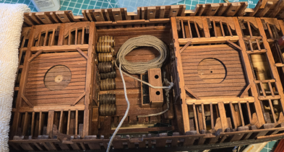

The second anchor cable was then done, possibly a bit neater, and then the smaller Kedge anchor cable, in a smaller coil:
I'd measured before starting for the available space for all three cables. I wanted them to fit, of course, but be pretty well constrained by the structure and cargo. Here, the first cable is placed in position:
And finally, all 3 have been CA glued in place, along with a couple more barrels:
As usually with my work, not perfect, but I think they will look okay once they're mostly covered by structure and decking.
I think next I will be working on the structure over the main hold, then attach the mortar surrounds and begin decking. But structure will be next.
Thanks to those who are following my build, especially for your comments and support. Those who have viewing this and other builds of mine in the past know that many of my methods are unorthodox. But for the most part, they get the job done. I have to often invent new methods due to my lack of experience and skill in certain areasl. At the least, it will give other builders ideas to ponder. Or to laugh at! :)ROTF

On to complete the main deck structure, now that the anchor cables are in place. These pieces confused me for a while:
The piece that was cut out for the stem reinforcement could have, I thought, been made of just a single piece of ~5mm instead of 9mm machined to ~5mm. I felt the same way about the above pieces, but after shaping and fitting them, I realized that each was slightly curved, to match the curvature of the main deck. Nice work and attention to detail, CAF!
I glued the two added crossbeams in place, using the main mast template to confirm the location:
This helps locate the beam longitudinaly, but also transversely, to make sure beam notches match up. Here I was just using the level as a straightedge, making sure the two new beams were at the same level as the rest.
I had made the mainmast surround structure separately, matching the template, rather than build it in position using the separate parts as shown in the instructions. I found all of these parts oversize, so when reducing them in size I had used the template to make sure everything was centered with the mast. At least that was my intention. I confirmed proper size and fit with the template one last time before mounting:
I also found that without modification of the side beams of this assembly, the bilge pumps could not be placed correctly, so notched them to allow the correct location.
After confirming its location, the mast support was added in place:
The small 1mm thick piece was added to it after installation, to insure proper spacing of the mast supports:

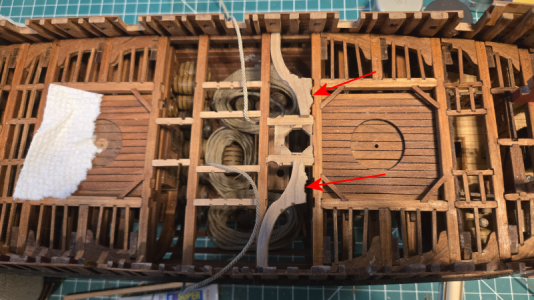

When I went to install the braces shown in the first photo above, these complex pieces, while nicely machined, did not seem to match the notches in the cross beams very well:
Oh well, I'll fit them as best I can. I can always use filler.
The instructions call for installing them first, then adding the longitudinal braces over the hold area, but they must butt up against these braces, so as usual, I did most things out-of-order. At least they were large enough to clamp securely while the glue dried:
I lost one of the small pieces, so decided I didn't need to add some smaller braces to the port size of the vessel, as they will completely covered by the decking. Adding the remainder, an brushing on a coat of Watco medium walnut, I've got the main deck structure complete (or as complete as it needs to be for my purpose):
I'm now wishing I'd left more of the starboard anchor cable un-varnished; it's going to be close to get enough of it to go to the anchor. I'll get it to work, though.
OK, time to start doing the main deck planking, most of it on the port side. At some point in that process, I'll position and glue in place the mortar surrounds, as I want to plank up to them, and not cut planking later to fit them in, as shown in the instructions. I feel I'll be able to do a much better job that way.
