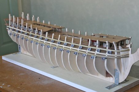

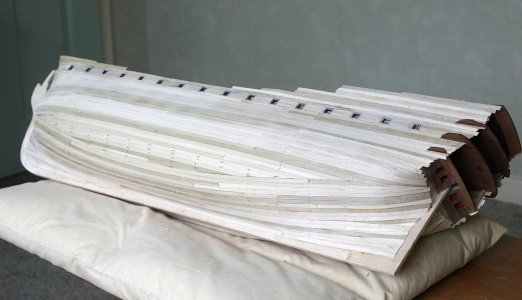

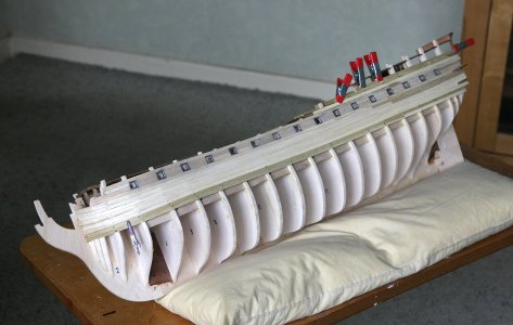

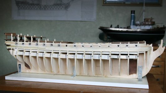

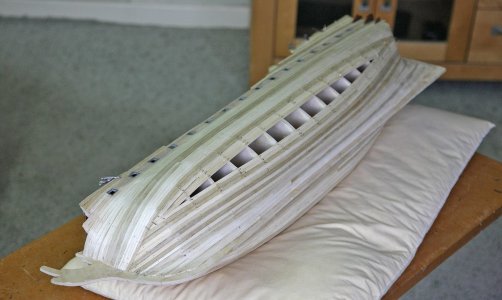

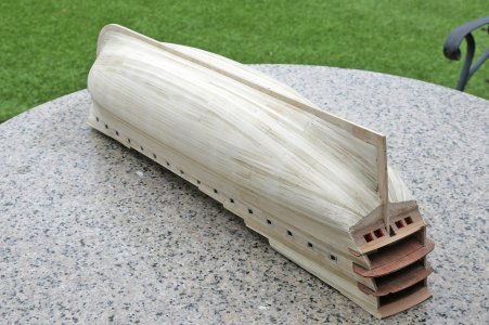

Hello, Here I am again, still catching up. This post will tell you that after errors and false starts I have at last got my head around this build and given myself direction. I think that it was starting up again after my lay off that I didn’t fully concentrate on what was needed.
You will see that I started the first planking using the method indicated in the instructions. After much re-alignment of the cast ports I laid the initial planks above and below the ports, I then started to plank between the ports. I really disliked this method so quickly gave up on it deciding that I would do it my own way. I ripped the ports and planking out and started over. I decided to build in ply backing strips between the bulkheads to mount the half barrels, as there were no decks I couldn’t put the normal blocks in, also as I couldn’t determine the exact location of the barrels yet this method gave me plenty of leeway. The cast open ports for the upper deck were ok so I used them as intended. I was now going to fully plank the hull then using the excellent 1:1 plans I would mark up and cut out the ports lining them normally. This was a good time to fit the quarter deck, I fitted the cabin facia and ships wheel under this deck, I don’t think that these will be seen but they will be there. I started the second planking by fitting the open ports into the walls of the main deck, planking around them, getting an acceptable fit and finish before getting stuck into the main job of planking.
I felt much happier about the build as I was now doing it my way and not trying to adapt to what was intended to be a simpler method which I believe wouldn’t have satisfied me.
Hi Kurt. You’ve arrived at the same conclusion that I came to. The first planking would terminated at the edge of each gun port, when completed you were supposed to file down the cast port to be level with the planking. There would be little support for that initial planking and an even flow of the planks would be difficult to achieve. As you suggested I ended up putting blocks where the half barrels would fit, planked normally, marked and cut out the ports as would be normal practice. I should have backed my feeling about this and saved quite a bit of time and effort, you will see all this in my catch up posts.

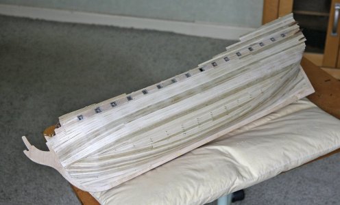

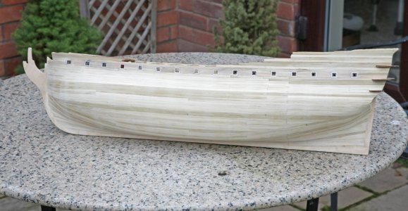

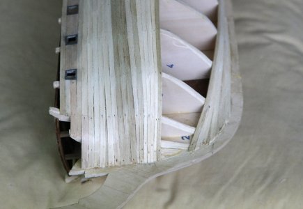

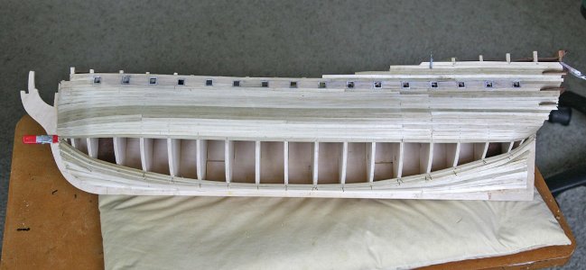

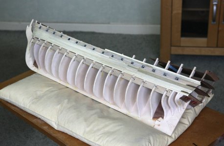

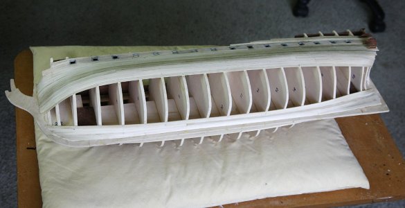

Again it’s still catching up, I wish that I could plank as quick as this in real time.. What I didn’t mention last time was that having taken away the start of the upper planking I was able to half cut through the upper arms of the bulwarks so that I could break them off ready to plank the inner walls, I’d forgotten to do this. I had even planked between them, I wasn’t thinking so this part of the deck planking needed to be removed. This was surprisingly difficult without damaging any adjacent planks.
I also didn’t mention that I took some time to sand the hull, reducing the bulkheads to get a good profile, at least I didn’t forget that.

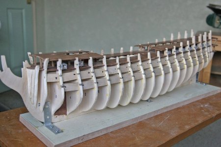

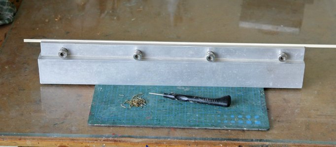

The first planking is made up from 4x1.5 white wood, again in nice condition. I used white glue and nails for this. I found that I could not pick up and hold these small nails due to my problem but fount that by using an Amati pin pusher I was able to get around the issue, I also use my homemade plank holder. The shape of the bow made things a little tricky in getting a good flow of planks. At the top it flared out, then a slight inward curve then going into a round bulbous curve, but lower near the keel it went into a slight concave curve, a better profile for cutting through the water. As you’ll see it didn’t cause an issue but I really had to think it through. The pictures show the hull after a very light sanding, next step will be a layer of filler and a good sanding to get the desired finish. This stage in a build is a significant landmark so I was quite pleased.
The pictures show the sequence of the first planking.
My homemade plank holder.
I see you were able to to use the metal gunports and still preserve the evenness of the hull surface. Wonderful work, Ken!
The Amati Fine Pins because they are so thin that they won't split planks and the points are needle sharp. However, they are long but very thin and hard to pick up with your fingers. So, you pick up with a needle nose pliers and then load it into the pin pusher. If you push them in such that the head is flush or submerged in the wood, the head can be sanded off during hull sanding easily, and the heads left behond won't interfere with the second planking layer by protruding from the hull.

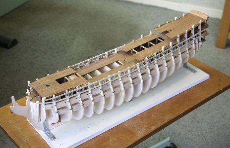

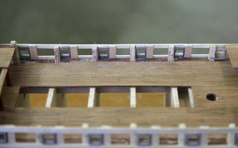

Hello and thanks for visiting my build and for the likes given. This is still catching up to the current state of the build. It shows the planking of the main deck, the deck beams and the stern gun ports.
The deck planking was made up using .5 x 4mm I think a dark sappelle which I fixed in place with white glue after darkening their edges. The nail marks were made with pencil, at this scale I thought dowels would be out of scale. I didn’t plank the entire deck but only the area that would be visible so as to be economical with the supplied planks. Many kits are not very generous with these planks and I didn’t want to run short, with the age of the kit they would have been difficult to match. I later realized that this hadn’t been necessary as even with mistakes there would have been more than enough to have fully planked the deck.

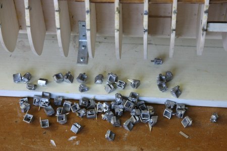

Next was to make up the stern gun ports. One of the features of this kit is the use of cast gun ports that you fit prior to planking. There’s about a hundred of these and as I’ve shown they were poorly caste and difficult to get them to fit and look good, they were also not suited to have recessed ports for the lids to sit into. I decided to build in my own version which would look better. After fitting, painting and planking I thought that I’d made the right decision. I then fitted the deck beams and upright pillars, a template was provided to get the correct curvature of the above deck. The basic part of the build was coming along nicely.
Absolutely atrocious g/port :eek: Exclamation-Mark castings. Personally, I've never liked any of the often supplied metal ports & lids, & most certainly never used any, as the pile of 'em on a shelf shows! I don't believe any ship had protruding lids, they all had flush fitting ones, from what I've seen. Correct me if I'm wrong! One fact is that Victory hasn't ever had them, as some kits include.

Hi Stuart, I couldn’t agreed with you more. I think that gone are the days when model companies expect you you actually make models, it might not attract the next generation of buyers who were probably brought up with piece together construction kits. They like the models but don’t have the time or inclination to learn skills, most youngsters that I know want instant success and I think that’s what kit sellers like to offer.
Hi Kurt, Thanks again for your input. I like your nails, I have never left nails in before it’s not me, so I leave a little sticking out and remove them when done, When we do things for a while we’re sometimes very reluctant to change what we’re happy with. Ken
