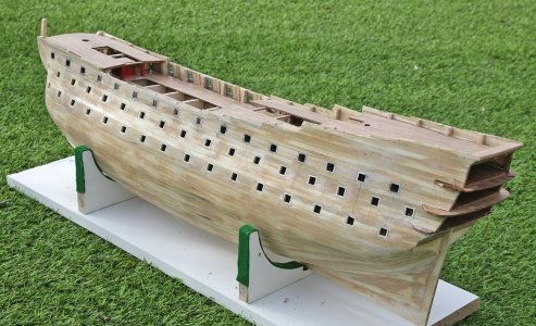

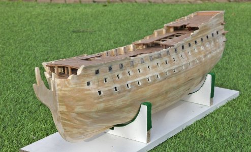

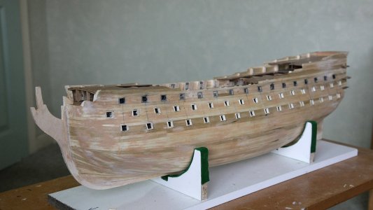

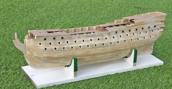

My last post was the finishing of the first planking which I thought was quite successful, this post shows the next step. I covered the entire hull with my favourite filler, Osmo, a water based filler that comes in many shades, it goes on smoothly, is hard but sands easily. After sanding I got the hoped for finish with all the unevenness removed and was now able to concentrate on getting the ports done.

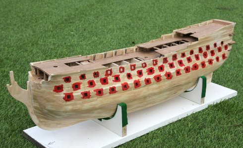

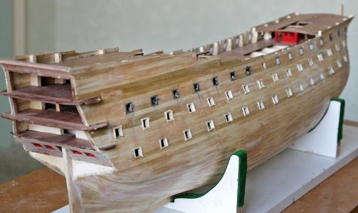

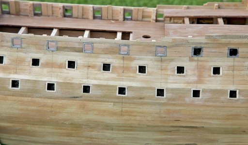

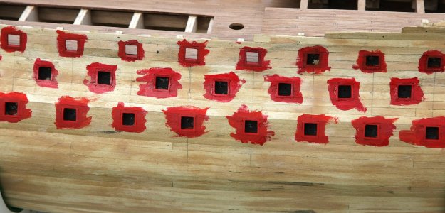

The 1:1 plans were invaluable and made getting their positions correct fairly easy. I used the upper ports as the datum points, I measured out and drilled a pilot hole at the centre of each port. I then made up a template with a rod through its centre, I placed the rod into the pilot hole and drew in the port. When they were all drawn and after checking several times I cut them out. I placed the template into the centre holes and used it as an accurate cutting guide I cut with a fresh surgical scalpel, I found that with a few light passes a clean opening was easily achieved, no problems, just a lot to do. Next will be lining them.
Excellent Plans
This shows my simple template in use
