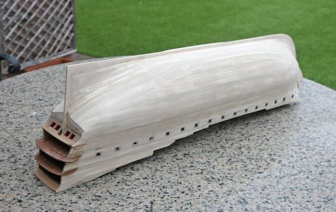

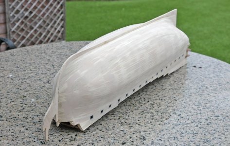

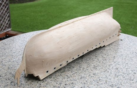

My last post was the finishing of the first planking which I thought was quite successful, this post shows the next step. I covered the entire hull with my favourite filler, Osmo, a water based filler that comes in many shades, it goes on smoothly, is hard but sands easily. After sanding I got the hoped for finish with all the unevenness removed and was now able to concentrate on getting the ports done.

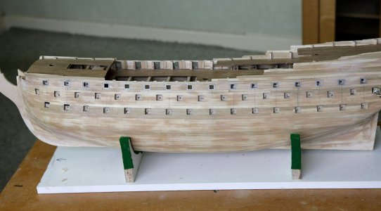

The 1:1 plans were invaluable and made getting their positions correct fairly easy. I used the upper ports as the datum points, I measured out and drilled a pilot hole at the centre of each port. I then made up a template with a rod through its centre, I placed the rod into the pilot hole and drew in the port. When they were all drawn and after checking several times I cut them out. I placed the template into the centre holes and used it as an accurate cutting guide I cut with a fresh surgical scalpel, I found that with a few light passes a clean opening was easily achieved, no problems, just a lot to do. Next will be lining them.

Hi Kurt. You’ve arrived at the same conclusion that I came to. The first planking would terminated at the edge of each gun port, when completed you were supposed to file down the cast port to be level with the planking. There would be little support for that initial planking and an even flow of the planks would be difficult to achieve. As you suggested I ended up putting blocks where the half barrels would fit, planked normally, marked and cut out the ports as would be normal practice. I should have backed my feeling about this and saved quite a bit of time and effort, you will see all this in my catch up posts.

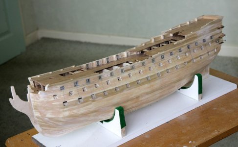

Hello, Here I am again, still catching up. This post will tell you that after errors and false starts I have at last got my head around this build and given myself direction. I think that it was starting up again after my lay off that I didn’t fully concentrate on what was needed.
You will see that I started the first planking using the method indicated in the instructions. After much re-alignment of the cast ports I laid the initial planks above and below the ports, I then started to plank between the ports. I really disliked this method so quickly gave up on it deciding that I would do it my own way. I ripped the ports and planking out and started over. I decided to build in ply backing strips between the bulkheads to mount the half barrels, as there were no decks I couldn’t put the normal blocks in, also as I couldn’t determine the exact location of the barrels yet this method gave me plenty of leeway. The cast open ports for the upper deck were ok so I used them as intended. I was now going to fully plank the hull then using the excellent 1:1 plans I would mark up and cut out the ports lining them normally. This was a good time to fit the quarter deck, I fitted the cabin facia and ships wheel under this deck, I don’t think that these will be seen but they will be there. I started the second planking by fitting the open ports into the walls of the main deck, planking around them, getting an acceptable fit and finish before getting stuck into the main job of planking.
I felt much happier about the build as I was now doing it my way and not trying to adapt to what was intended to be a simpler method which I believe wouldn’t have satisfied me.
