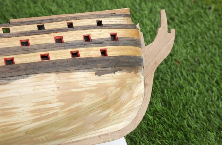

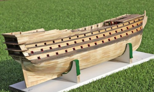

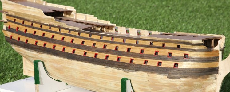

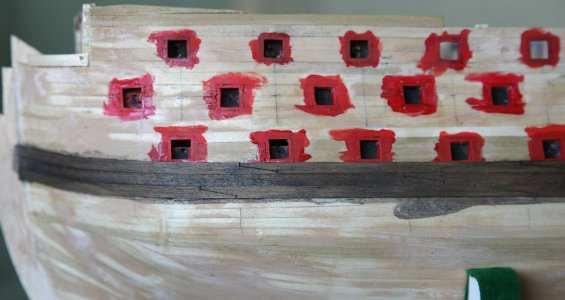

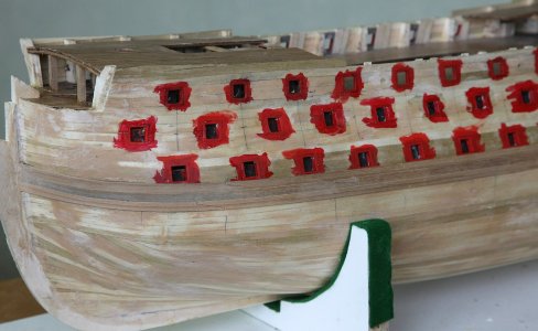

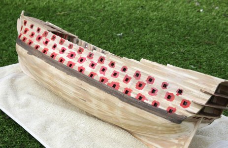

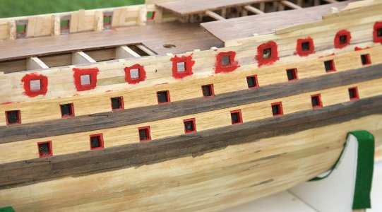

Good morning. Having completed the first stage of the hull it was time to start the process of second planking, Normally I would apply the second planking starting at the sheer strake level with the deck and work down, then add the strakes and wales on top of those planks but this kit is designed to build the wales in rather than add them on later. So that they would be in the correct position I decided to start with the main wale and work upwards placing each wale according to the plans. These wales were made up from 5x2mm walnut strip, there were thankfully enough to not worry about running short because of mistakes. I soaked then shaped them using the heat from the shaft of a large soldering iron. I used long strips for ease then cheated by cutting in the scarf joints to give them a better appearance. I stained them using an ebony coloured spirit dye, I was quite pleased with the result.

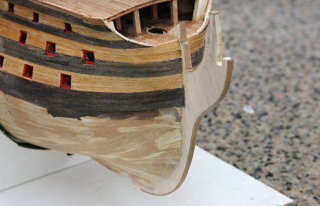

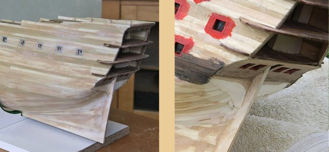

When I studied the plan closely to position the wale I saw that I’d shaped the stern wrongly, I had made the part below the gallery flat instead of curved, it was fairly easy to correct, I must pay more attention to the plans or I’ll end up in trouble.
BEFORE and AFTER

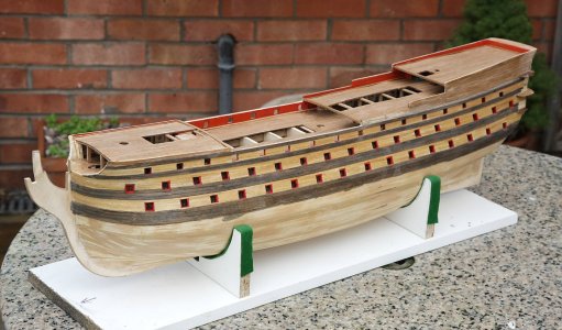

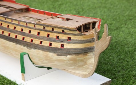

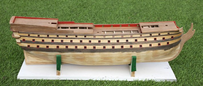

The build continued. Not a great deal to show for many hours of work, but good progress all the same. The planking on the upper part of the hull is made up from boxwood, 1x3mm strips, this gives distinctive lighter colour bands between the ports without the need to paint, I like seeing the wood grain so was pleased with the unusual choice of wood. This is quite a large hull so I’m sure you’ll appreciate the extra time that it took using narrow 3mm planks and having to size them exactly between the ports. I completed the first section then put the middle wale on which was made up from 2x3mm walnut strips. I stained the wale ebony again but before doing that I sealed the boxwood so that I would be able to wipe it clean if some stain got onto it. It was coming along nicely as I’d hoped.

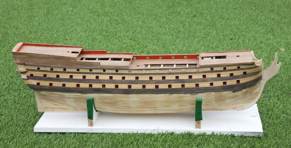

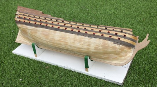

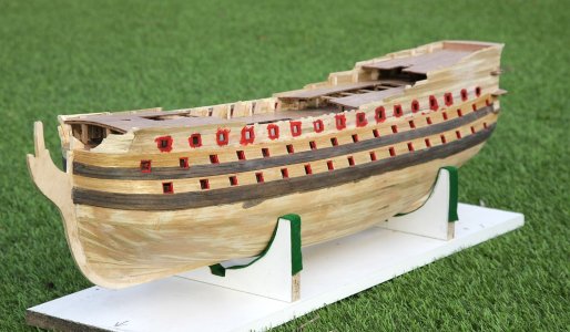

Hello. More of the same. Working my way up with the boxwood planking, wales and strakes. The wood is good quality and it is all coming together nicely.

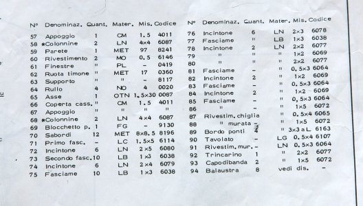

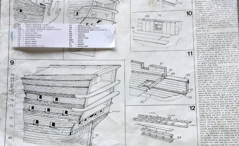

A word about Mamoli instructions which are quite comprehensive. You get a plan, a detailed diagram of each section and a reasonable description. You will see that every part is given a number, even individual planks, this number can be found in a list at the end of the instructions, it shows the type, size and quantity of wood to be used, you really can’t go wrong. It would be nice if all manufactures, especially Chinese ones could be as good.
I have Mamoli's Privateer Rattlesnake. Mamoli seems to have instructions that are well put together with decent illustrations. Corel provides a few large, well sequenced drawings and detail schematics, but the written instructions are almost nonexistant, with no descriptions on how to fashion parts, so you have to draw upon building experience to build them. In both cases, having an Italian dictionary or translator is needed for non-Italians.

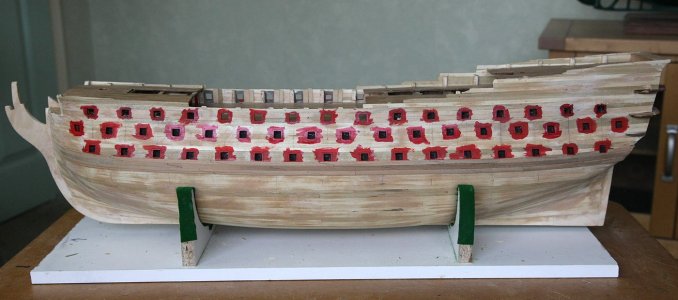

Good morning all. I’ve decided to bring you fully up to date on my build otherwise I’ll never catch up. What looks like just a small progress represents many hours work.

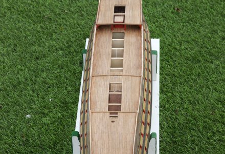

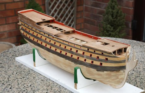

I covered the rear upper hull with .5mm walnut strip, it didn’t matter that it was different than the other woods, it was easier to apply and finish and it will be painted a French blue. I removed the bulkhead uprights from above the deck and completed the deck planking. I determined the height and positioning of the side walls and finished them off, a tricky task. I lined and painted the inner walls red before adding the waterways and I put in the deck edgings. The keel and prow are covered with 1x4mm walnut strip as is used for the lower hull planking. I first covered the edges then worked out the pattern to apply for the sides. I fitted them so that I gave myself a rabbet line to fit the hull planks into. There you have it, at the moment I’m sanding the hull planks to get crisp clean edges, a task that doesn’t show any result for the amount of time that it takes.
