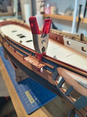

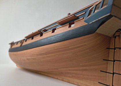

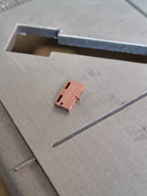

Very nice touches. Clean work. Speaking of clean work, may I suggest you add this 3D printed aftermarket accessory for the Captain's loo? I'm certain it will be visible through the gallery window. Cheers!
Haha, I see new business opportunities here!

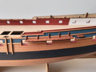

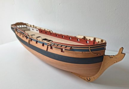

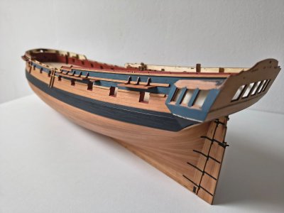

Hi Ronald-V. I know this is not my business but may I suggest not to paint with white paint over so great looking planking? Paint will hide all the wonderful work you did.
Thanks Richard and everyone else for the likes!Quite something.

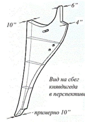

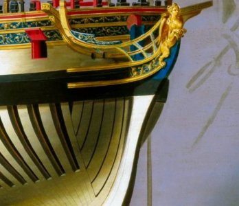

Where are you getting that last part about 4 ins at the figure? I transcribed the whole contract and I can't find that in my transcription. I looked at the knee of the head entry and it is as follows:The knee of the head to extend to the upper side of the upper Cheeks, to be 11ins thick at the stem & at the upper part or breast of the figure 4ins,
The taper at is quite a lot. There is similar tapering vertically as well, just as there is on the stern post and rother.
Knee of the Head | The knee of the head to extend to the upper side of the upper cheeks, to be 11 ¾ in thick at the stem, the 2 upper bolts to be 1 ¾ in diameter in the knee & 1 ⅝ in in the stem, the 3rd 1 ½ in diameter in the knee & 1 ⅜ in the stem, the fourth to be 1 ⅜ in in the knee & 1 ¼ in in the stem, the 5th to be 1 ¼ in in the knee & 1 ¼ in in the stem, & all the rest to be bored through with proper sized augers, that is to receive the bolts in the last drift, that no reaming may be suffered from the stem, in that the holes be bored before the canvas is put on, & the knee swung off to observe if the holes are all good, before any bolts are drove. To have a throat piece of sufficient depth of elm, tabled & billed, & well secured with bolts drove up with plugs. |
Thanks Allan! Agreed, that would be a nice additionThe rudder, and everything else is amazing. I thought you might find the following dimensions interesting as they are from the contemporary contract for the Sphinx class ships Perseus and Unicorn. https://www.rmg.co.uk/collections/objects/rmgc-object-459363
The stern post to be of good sound Oak Timber of the best kind free from defects square at head 12 ½ ins (which is to run up to bolt in the Quarter deck Beam) fore & aft on the keel, the back or false post if any included, 2ft. Abaft the rabbit at the Wing Transom 9ins & on the keel 2ft. not to have less than 1ft 4ins main post abaft the rabbit, the breadth athwartships at the head to be continued down as low as the Wing Transom & from thence to begin its tapering to 8 ½ ins as before observed that the main keel is to be wrought at the rabbit thereof, not to be bearded until the back is on & then to be no more than the tapering of the keel requires.
A transcription of a contract, when available, could be an interesting addition inside a kit box.
Thanks Thukydides, big oops on my part, my mistake, the transcription I quoted is from another contract. You are correct in that the Perseus contract does not address the taper,,,,, but, the knee of the head did taper substantially, based on other contracts and photos of contemporary models. This is addressed in some detail in the Swan Class book series by David Antscherl and Steel gives scantlings on this. For example Steel shows the siding of the knee of the head of a 24 going from 11" at the stem to 4" at the foremost part. It could be that the taper on the Sphinx class is different than 4 inches but I would bet the thickness at the seat of the figure head would be no more than 5" or thereabouts for this class. I was surprised that the Establishments, like the Perseus contract, do not give the siding at the fore part, only at the stem.Where are you getting that last part about 4 ins at the figure?
