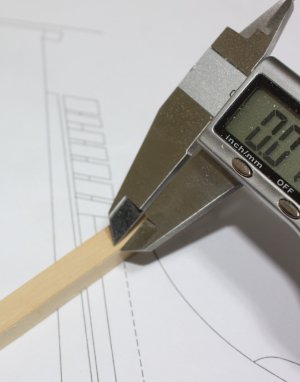

And now the fun begins with joinery. The scarfs are not so difficult but the boxing joint is still as difficult as ever. They were lined with material so I went with blackened glue to represent the material used on the actual joints. The black is 0.56" thick. I have no idea what the thickness of the material that was used but I think is was far less than 1/2" when squeezed together. If I do redo it thinner I may just go with a clear joint. Still have time to soak it in alcohol and dismantle and go with plain glue. On one hand I want it to be clearly visible, on the other hand nearly invisible.

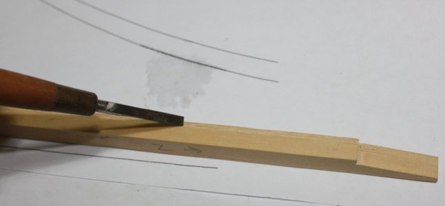

I am decidedly unworthy to counsel you on anything related to ship modeling...IF anyone has a different way to cut the rabbets accounting for the angle being dynamic from one end to the other, please share. I will be testing at least the midships portion with an 90 degree pointed end mill on my milling machine. I have my doubts, but it may be worth a try.
