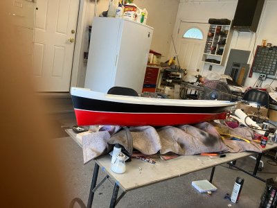

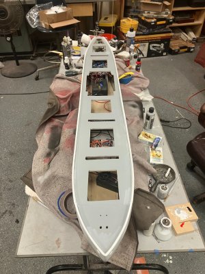

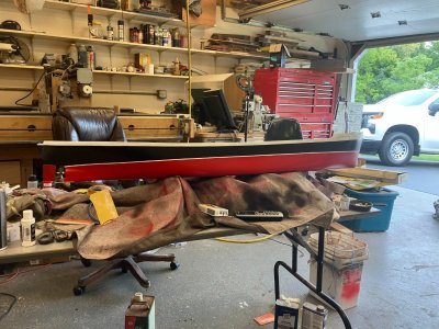

Been waiting on electronics to get here and I got everything but the LED's for lighting and running lights. I had purchased a DUMAS 6v motor from ebay after DUMAS shut it's doors. When I hooked it up it was dead. Seller never got back to me so I hooked up a volt meter to the contacts and didn't get an reading when I spun the shaft. (No continuity). Figured the brushed were screwed up so I opened the can and sure as sh*t, one of the brushes was bent to not touching the commutator. Straightened that out and got it running. All the electronics are working correctly so I can finish strapping the wire to clean it up. Next step it to mount the deck so I can get it ready for paint.
She’s looking pretty good, Skipper! I need to get back working on mine.

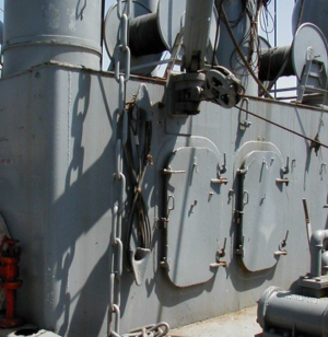

I've noticed that there were 'access' doors on the bases for the masts. Not sure what the bases are called. I'll have to model them and add them. There are also cable reels on the top of the bases. Does anyone know that they were used for? Also, which direction should the air vents be facing? It wouldn't make sense to have then facing forward which would allow heavy seas to enter.
