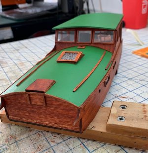

BB.Grex, I’m building the Pilar too, got the hull planked and the cabin almost done. I screwed up by attaching the cabin roof supports before installing the cabin furniture but I haven’t attached the cabin roof yet until after the cabin interior is done (thankfully the roof support over the dashboard came loose so I can access the interior pretty well).
Question: how did you mark out the location of the hole for the rod going up to the flybridge? I’m thinking of dry-fitting the roof and either measuring the location or maybe putting some paint on the end of a wood scrap and tapping it up onto the roof, then removing the roof and drilling the hole.
It’s always best to make a template out of heavy paper stock or out of light cardboard…easier to screw up the template than go back and fix it and still have to get hole positioned correctly….don't ask me how I know…it was ugly!!!!BB.
1. I made that same mistake also with the cross beams, and had to work around them. Don’t forget if you’re going to put a bell in there get there now.
2. For the tube from lower to upper level, my pictures show where mine ended up, as far as the roof holes locations, I used a piece of white card stock and cut it to match the roof, taped it in place, then started to find the correct spot for the holes. Once I had the tubes through the paper to to lower console and straight I marked the paper roof as accurate as I could. I then transferred the paper to the real roof crossed my fingers and drilled. Tiny holes first in case I had to adjust..

Gregg. I believe it’s basswood leftovers from previous buildsContinued nice work, Grex! What wood are you using for these extra trim strips you will be placing? Should look nice when you get them on.
I feel your pain. But you have done an outstanding job on this!Gregg. I believe it’s basswood leftovers from previous builds. It easy to work with and stains well. I have a few molding sharpers from Artesania Latina that work ok, most of these trim pieces are quarter round ( as close as I can get them to quarter round with these shapers ) I don’t have fancy equipment. And at 75 years old I don’t plan on buying any.
