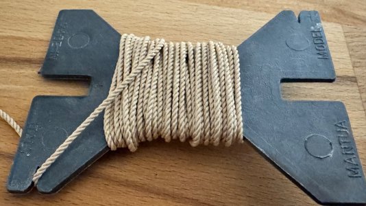

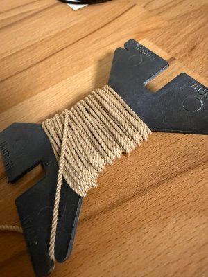

Today was another solid step forward on my 1:50 scale SAN Felipe build — and this time it was all about making heavier, more realistic rigging rope.
I spent the day on new rope walk dialling things in, and I think I’ve just about hit a really nice sweet spot.
Rope Specs:
  • Thread: Gutermann E151
  • Layup: 3 x 15
  • Tension: 10%
  • Initial weight: 430 grams (first wind)
  • Final result: ~1.3mm Z-laid rope
⚙️ The Process
I started by loading up the bobbins with the Gutermann E151 — this thread continues to impress me with how consistent and clean it twists.
Running a 3x15 configuration gave me a much fuller rope compared to earlier tests, and adding the 430g weight on the first wind made a big difference in keeping everything tight and even during formation.
The key thing I focused on today was:
Maintaining consistent tension across all strands
Letting the rope form naturally under load instead of forcing it
Once everything balanced out, the rope came together beautifully — nice tight lay, even spacing, and no loose fibres kicking out.
Final Result
The finished rope came out at around 1.3mm, which is pretty much spot on for what I need on the SAN Felipe at this scale.
It’s got:
✔️ A really clean, tight twist
✔️ Good flexibility without being too soft
✔️ Enough body to hold shape on the model
✔️ A proper Z lay, which is exactly what I was chasing

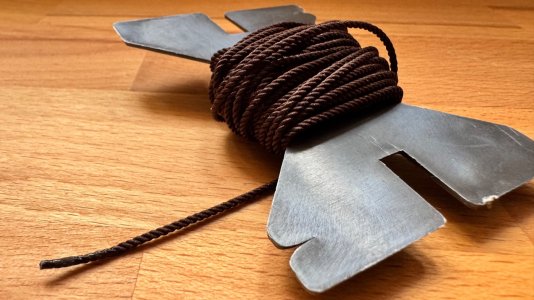

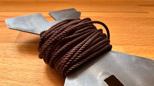

The darker rope you see in the photos has also come up brilliantly — gives a great contrast depending on where I use it (standing vs running rigging).
⚠️ Lessons Learned Today
Every session I’m learning something new with this rope maker:
  • Heavier initial weight = better strand control
  • Higher strand count (3x15) = fuller, more scale-accurate rope
  • Consistency is everything — if one strand is off, the whole rope shows it
Also really starting to understand how small changes in setup make a huge difference to the final diameter and look.
⚓ For the SAN Felipe Build
This 1.3mm rope is going to be ideal for:
  • Heavier running rigging
  • Certain standing lines
  • Areas where I need the rope to visually “read” correctly at 1:50 scale
It’s a big step up from what I could previously achieve — especially compared to the limitations I hit with the other rope maker.
Final Thoughts
Honestly, pretty happy with how this turned out.
This is getting very close to production-quality rope for the build, not just testing.
Still more experimenting to go… but this setup is definitely a keeper.
If anyone else is making their own rope and wants to compare setups, happy to share more details

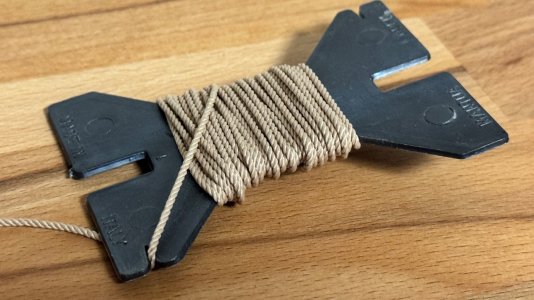

Hello all,
it’s been a little while since my last update, but there’s been a very good reason for the silence…
I’m finally back on the 1:50 scale SAN Felipe Spanish warship, and what a journey it’s been just to get to this point.
The biggest holdup?
Ropes… and lots of them.
When I got to the rigging stage, I quickly realised something didn’t sit right. The ropes supplied with the kit—and even what I could source here in Australia—just didn’t match the level of detail and realism I’m aiming for with this build. At this scale, rope isn’t just rope… it’s one of the most visually dominant features on the entire ship. If it’s not right, the whole model suffers.
So instead of compromising, I made a decision…
I was going to make my own.
What I thought would be a simple process turned into a two-month deep dive into traditional rope making. I had to learn everything from scratch—lay direction (S vs Z), strand counts, yarn combinations, tension, and scale accuracy. I also went through two different rope-making machines, and to be honest, the first one nearly had me pulling my hair out.
There were failures.
There were ropes that unravelled.
There were sizes that just didn’t look right.
But slowly… things started to click.
After a lot of trial and error, I’ve now reached a point where I’m producing ropes that I’m genuinely proud of:
✔ Correct scale thickness
✔ Consistent lay and tension
✔ Clean finish without fuzzing
✔ Proper contrast between standing (black) and running (tan) rigging
Seeing those clean black standing lines paired with the natural tan running rigging on the ship really brings it to life. It’s one of those moments where you step back and think… yep, that was worth it.
