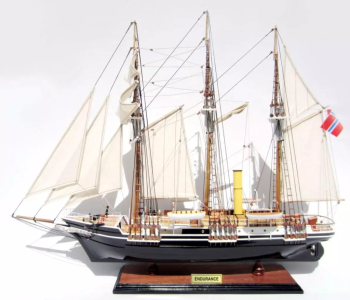

Testing the Mast top running lights & they work. You might also note the front mast dead eyes have been moved off the rail on to the hull side as the other masts. Except for this kit, I could find no evidence that the dead eyes were fixed to the rail, in fact what photos I have seen suggest otherwise. I would be please to hear other opinions ( preferabley with evidence)
