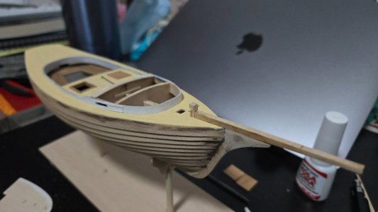

The biggest difference between my build and the kit is the hull planking. The kit provides spiled planks, which is a great way to help beginners understand planking concepts. However, following the examples given in many of the sources mentioned previously, I wanted to use lapstrake planking. This meant that I ultimately wasn't able to use the kit planks--in hindsight, I should have saved the wood and not laser-cut them. I took a lot of care while lining out the hull, especially as the overhanging stern is a challenging shape to plank.
To plank, I marked out the overlap on the lower plank, sanded the lands with a small sander (the width of a plank, with sandpaper only on one side), then marked out the shape with tape to cut the wood to size. I then soaked and clamped in place to get the right curve and twist.
I was really pleased with how the lapstrake planking came out. It had its own challenges, especially around the stern, but it wasn't much harder than carvel planking. If anything, it may have been slightly easier because the planks overlap, meaning that I didn't have to do a really precise butt joint between them.

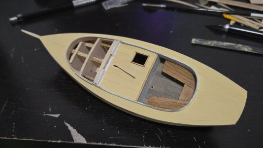

The kit deck didn't quite fit properly, due to the modifications I had made, leaving a gap in the center. As I planned on planking it, I was fine with this. I also opened up one of the fish well hatches--the other will be closed, so no need to model more than the hatch on it.
The coamings were a real challenge. I ended up cutting off the forward portion of the coaming and replacing it with a strip with the grain running vertically, making it much easier to curve.
I then began adding deck planks. To avoid getting paint on the coaming, I'm painting each plank individually before gluing (then lightly sanding/scraping the joint afterward and touching up the paint job). I'm not really sure how accurate my deck plank layout is. It's a very challenging shape to plank due to the large coaming in the middle. The only clear photo I could find was of a yacht from the 1970s which used a lot of narrow curved strips for the deck, but that struck me as excessively complex for a simple fishing boat from 100 years prior. So, I started with king planks and covering boards. From there, I'm laying out the planks with an eye to avoiding really thin slivers, which would be very difficult to nail down, and minimizing the number of seams to caulk. This has resulted in nearly every plank being irregularly-shaped, which would certainly drive up the price, but the actual decked area is pretty small, so this might be acceptable. As can be seen, I also framed the open fish well hatch.

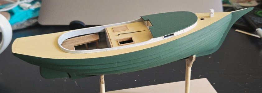

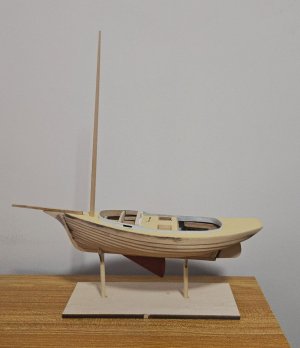

I've made a bit more progress on this build. I was able to finish up the deck planking, add the dummy port fish hatch framework (which will be covered by the hatch itself), and add window covers, among other parts.
With the mast dry-fit:

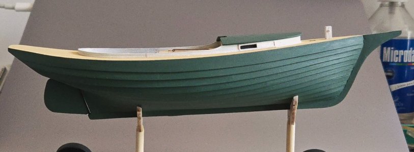

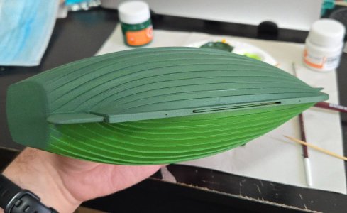

I started painting the hull a light green color, but decided it was too vibrant, so I repainted the hull a darker green. Below, the contrast between the two shades is clear.
I've also added the cuddy roof. So far, I'm happy with how it's turning out, although I really need to weather the model a bit (so far only the cockpit is weathered). Right now it looks too yacht-like.
