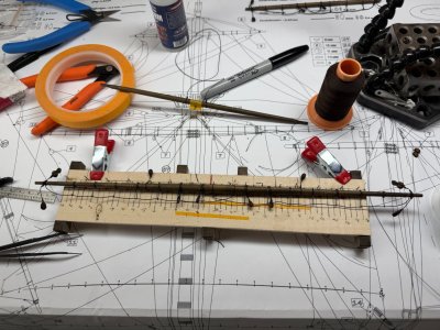

What do you think?
If I were to put sails on this ship... Is it best to attach the sail to the yard before attaching to the mast and then the ship? Or would the sail be in the way too much during adding the standing rigging?
Or put the masts on, then the standing rigging, the add the yards with sails attached to the yards? 1.jpg
Hi. What Paul said. If the sails get in the way for any particular job you can always clip them up and out of the way. Small sewing clips (search Amazon) are handy for a range of jobs and are pretty strong.
