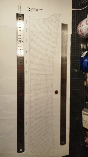

Hello friends,
in preparation for the single formes I today added the sideview together with an metic, imperial ruler and an onecent coin:
The Rest of the day I added superglue to a centerboard and looked news in YouTube: As the world went crazy - so modelshipbuilding is to me my best option to do.
