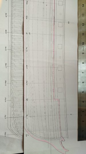

This is certainly the most spectular drawing giveing a good idea of the hull's real size:
Here in pink the spine's/CB's outline:
Here the hole hull lines drawings as a hole:
Here again my way to cut the plan to the overlay the two outside's ends of the hull:
Here the interesting cuts through the hull:
So all the plans are basically ready and now I have to glue together all the formers and to deside how often to place the bulkheads become formers fitting in the slots of this spine:

Dear friends today I was able to work on the plan set further in and add the important lines I do need in the coming developing of my "kit parts". So I am ready to copy these drawings later today and start to deal with the famous and important "Line N° 9" that is noted in all the frames' drawings.
So I added the CWL
, the frames,...
and Line N°9 certainly also:
This evening I will hopefully have the full Set of drawings complete.
Greetings from Berlin Card Yard, Chris
This evening and tomorrow I will deal with the combination of my A3 copies into the füll length drawings they were made from by, cutting, glueing, and avoiding overlapping as much as possible...
The given bulkheads and the given frames in comparison
But the most aft bulkhead and the frame are differing by one frame :eek: I have to look what is right...
