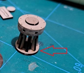

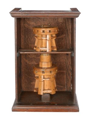

Dear Lucian, Amati has misled you.
The ring shown by the arrow was missing from the top capstain. The lower drum also lacked a lower ring, as Amati showed.
The number of ribs is also incorrect. The rib thickness is also incorrect, making the capstain look unsightly and unrealistic.
The number of holes for the levers should be greater.
