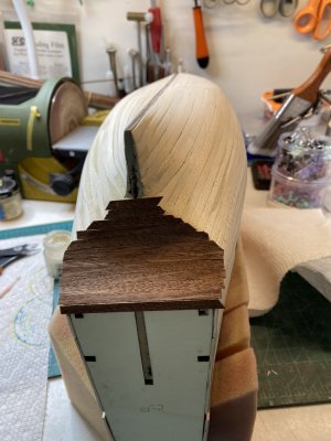

The rear of the hull received the second layer of planking.
This was trimmed and sanded flush.

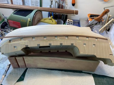

I then started paying down the second veneer along the hull. At this point I am not tapering the veneer just allowing it to follow the curve of the ship.
This stuff is very thin. Stated to be 0.6mm thick.

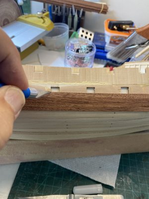

Here I am notching out the gunports from the veneer. I am planning on starting to taper the veneer going towards the keel.
