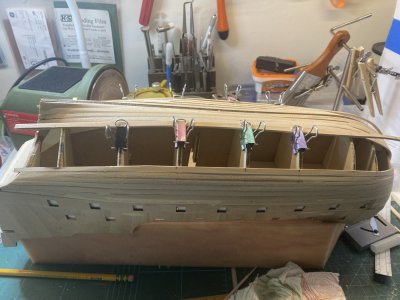

To start planking the hull I measured the length of all the bulkheads to taper the planks. It looks like it will take about 20 planks on each side to do the trick.

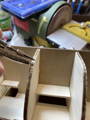

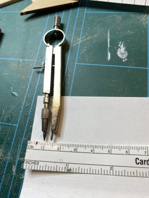

Reh thickness of the planks which are 5mm wide will vary from the full 5mm to 3.3 mm for the bow of the ship. To transfer the tick marks to each bulkhead I used a compass, setting the with that each plank will use at a particular bulkhead and marking them.

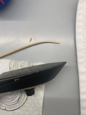

The first plank was soaked in water for a few minutes, the bow bent using an iron to wrap around the curve of the bow. The stern which curves down a bit was also curved slightly. The next plank in the stern will be made a bit wider to make up for that curve and produce straighter planks. I used CA glue to secure the front curved area and wood glue for the rest of the length.
After laying down the first planks I realized that there is an unplanked space above the first planks where the gun ports are. This means the remains 19 planks will actually have less space in the bow that I calculated and will have to be tapered more. I remeasured the area and each plank will have to be about 2.5 mm in width at the bow.

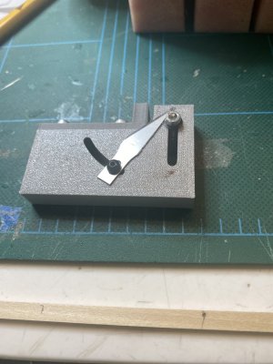

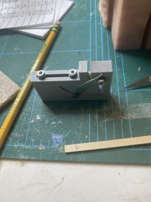

A little while back I bought this mini plane trim the edge of the plank that lies against the hull bulkheads. Forgot where I first saw it, but I believe I picked it up on Amazon for about $4. It is 3D printed. You can adjust for the width of the plank you want and the angle of the blade which is just a replaceable x-acto blade. It works well. After passing the plank through the plane a few times I finish with a quick pass of sandpaper.

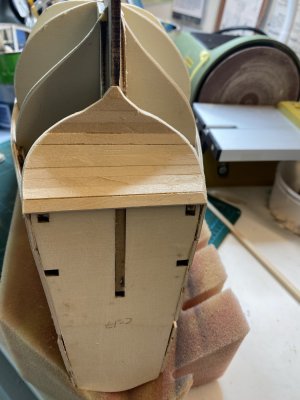

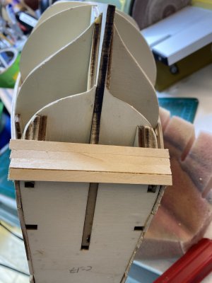

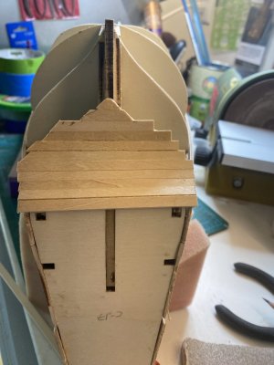

I decided to start laying a few planks from the keel up. In my limited experience it is better to meet in the middle, so to speak, to more easier fit in the last few planks. The "garboard plank here is set very differently than other ships I have built. There is no rabbet to key the plank into. In addition on the bow the plank rises up above the keel on both sides forming a slot where apparently the false keel is placed. Of course this is really mentioned no place in the sparse directions but if you study the pictorial included and looking on their you tube building directions you can figure it out.
You can see in this picture how the planking in the front sets proud of the keel.

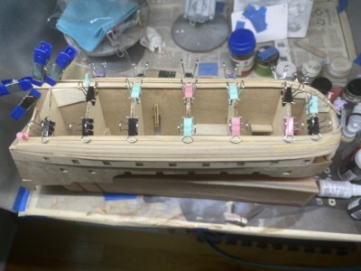

I soaked th stern end of the plank in water for a few hours to make it more flexible to bend 90 degrees to clamp onto the back of the keel piece. I first glued and held into place the plank along the main structure of the hull then clamped the stern part into place.
The bow part of the plank was kept a bit long so I could tack it in place and then trim it to size after. The piece was motioned and curved using a hot iron.

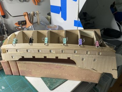

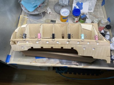

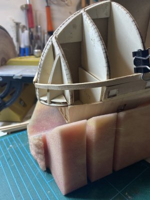

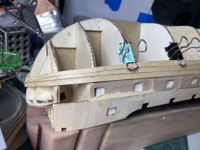

I thought I might ask for advice with the next bit of my build. I have got to the part after completing the planking where I have to attach a few strips alongside the hull but below the lower gun ports. I have bent the strip to the same shape of the hull and I have to attach it to the hull. I intend putting large elastic bands along the straight sides of the hull but how do i hold the bow section in place after glueing. I have attached a photo showing it from the instruction sheet.
Very nice Rob, I am a bit in front of you on the same model and it has its challenges.
That will indeed be a challenge. On the planking of the bow pieces I have sometimes use gel like CA cement. I would put a few dots of CA along the curve and hold it in place until it sets. You can use a CA accelerator (ZAP kicker is one brand we have here) to cause the CA to instantly set. The rest of the strip I would use PVA glue.

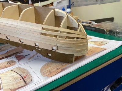

It is a joy to see that you marked out the plank breadths so the planking does not look like the instruction photos above, which are someone's fantasy. (I know this is a fantasy ship, but....) Note that the wales in the photos above stand proud of the planking at the stem which is also unrealistic. When you get to that point, remember to sand the thickness to match the adjacent planks as close as you can so the strakes of the wales fit into the rabbet the same as the other planking and does not stick up at the rabbet.
Thank you Allan, I am unsure why they do the planking the way they do. It strikes me as being very ugly and I doubt any similar method was used on actual ships. I think one reason they may do it is to simplify the "instructions" which makes a passing mention of tapering. Also it would be difficult to explain the tapering by the visual method they use. But it goes to show there is certainly more than one way to skin a cat.

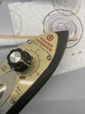

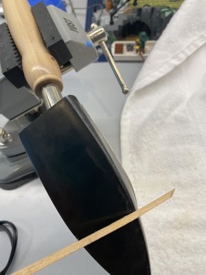

After bending a lot of planks I thought they may be a better way. What I did it mount the handle of the iron into the jaws of my vise. I then passed the planks across the face of the iron, using a paper towel to hold the close end. It actually seemed to work well and gave me better control of the bending process.

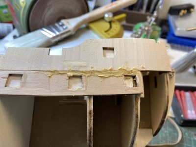

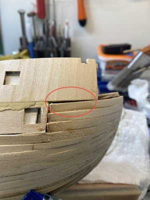

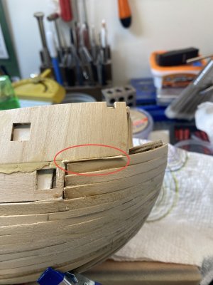

With my so - so planking ability, more frequently than I want there are gaps in areas between planks.
If the spaces are large enough I take the shavings from the planks and use pieces with a little glue to fill the space.
These are sanded down to match the hull.

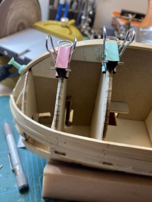

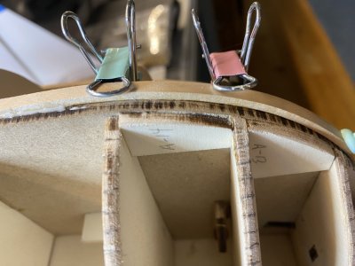

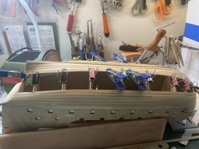

Hi Rob,

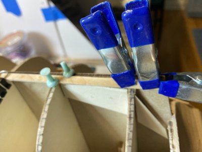

Interesting seeing your photos with your issue. When I did mine I tacked the planks to the bulkhead behind the planks then removed the pins a day later after the glue has dried. As you can see in my photo the planks finish at the bulkhead so that I can pin the plank to it. Then removed the pins a day later. You can see the holes from the planks that have had the pins removed.
