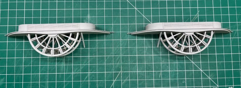

I fabricated these wheels out of resin.

Hi Doc. The red lead paint used back then was likely orange rather than maroon—which is how it's shown in the 1/96 scale kit—though I believe the hull below the waterline was actually copper-sheathed. As for the funnel, it’s better painted black than wrapped in paper first; I don't quite get that step. The paddle wheels are very fragile; the wood grain causes them to practically fall apart when you remove them from the sheet. In my post, there’s an STL file for printing them in resin as solid, complete units. If they break after you’ve glued and fixed them in place, repairing them would be a real hassle. If you do use the kit parts, I recommend coating them with CA glue before removing them from the board; that adds some strength. The hull planking is made of very thin wood—excessively so. I plan to use the traditional method, or perhaps fill the spaces between the frames with balsa wood to create a solid hull first. The instructions are terrible, with tiny photos. The plans are very basic; the instruction to turn a square strip into a round one is essentially the reverse of "squaring the circle." In Spain, the kit originally sold for €400; now it’s €239, which is still very expensive for such a simple ship. The cast metal parts need touching up and filing; resin would have been better. Regarding the bulwarks, I don't understand why the kit requires them to be modified to fit the cannons—something isn't right there. Either the bulwarks are wrong, or the cannons are too big. The fact remains that the ship was built the way it was; I doubt they added extra height just to accommodate the cannons. I'm glad you're enjoying the build, and I look forward to seeing that beautiful ship finished. Best regards.
I wonder if the kits sold in Europe are different from the ones sold in US? My paddle wheels are sturdy 3/32" stock. I would have a hard time accidentally breaking them.

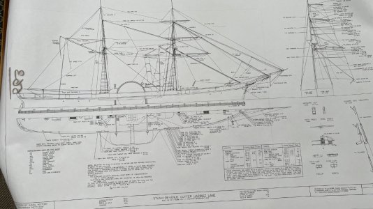

If you are interested, you can buy the plans on which the kit was based from the Smithsonian Institution. They were drawn in the 1960s by Merritt Edson
The process is a bit old-fashioned - no online ordering, you have to pay by check or money order, but they are very responsive.
