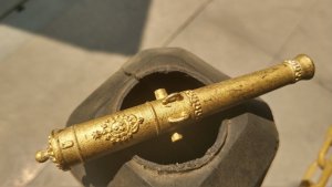

About 10 month ago., I’ve got a bronze cast french 8-pdr cannon barrel from ShiCheng model. I think that's must be the Xebec le Requins armament. After I checked some french ship plans and construction manuals,I think the french frigate la renommee must be the same system as Le requin.

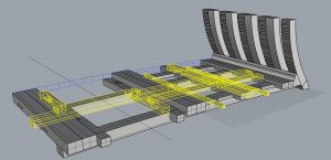

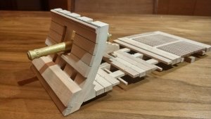

According to the plans of la renommee,I drew the 3D models like this

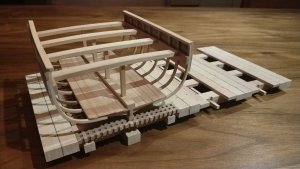

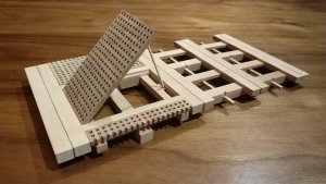

After finish the plans and set the scale. I start from deck beams

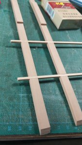

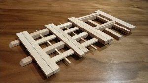

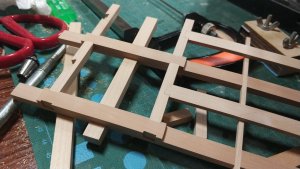

Assembled the carlings and ledges

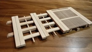

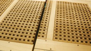

build and assembled the grating

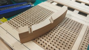

in this section there,we could see a launch on the grating. so I build it up.
drill and attaching the grating nails

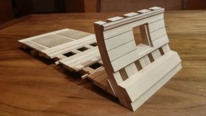

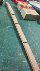

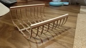

make grooves for gunport then glueing frame
make gunport, deck planking and hull planking and waterway.
after done this all,I find a big mistake. French ship usually have no gunport lid on the upper deck. So I have to rebuild the hull planking.
not complete to be continued..........

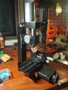

Do you use cnc machining for your woodwork?
This as you also prepare the drawings in 3d.

Very precise and accurate wood-work -> perfect angles, all joints same thickness, the accurate nailing pattern - WOW
1:24 is a beautiful scale for making this perfect, like you do - also your timber quality is first class - so everything prepared for a masterpiece :cool:
There will be a lot of questions coming up, with "How you did this? and that?
f.e the gratings are great - so once maybe you can show us the step by step production of your gratings (like Bernard Frölich?)

great presisjon on your milling tool, super:)
