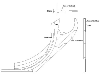

Neptune..got bored with rigging cannons so I added 35 mm to the keel..I plan to use the supplied stem veneer as it looks ok..what did you taper the stem to on first RC build
For RC the dimensions may be slightly different, but for other English ships of similar size the stem is tapered from the top down from about 12" at the head to about 8 inches at the boxing joint to match the keel. The knee of the head tapered fore and aft as well as from the top down. The knee of the head went from about 10" at the stem to about 3" or 4" at the fore part. It tapered as it went down to the same thickness of the stem.
An example below for an earlier ship may explain better.

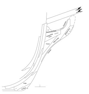

The following shows the various names of the parts of the knee of the head. The shapes of the parts varied a lot for various years and ship size.
