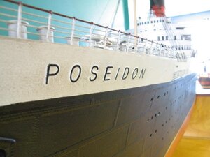

I’m looking for decals of alphabet letters that will fit the 1/570 scale Revell kit of the Queen Mary. I‘d like to convert it to the Poseidon from the disaster movie of the 70’s. Anyone have any links or ideas to find this?

Old Chartpak letters, or there are model railroad letter sheets. The descriptions never give the physical size, so you are better off going to a model railroad store near you.
What would be the height of letters? You might have somebody to cut them with laser of thin plywood, laserboard, styrene sheet or similar. Or perhaps etch from thin brass sheet.
I've seen some brass letter too. The railroad decals can be had as dry transfer or waterslide, the out of production Chartpak are dry transfer. What height do you need? I may have some that you can have.
1/570 scale equivalent to the Queen Mary letters, I would say 1/16th inch tall?
I have some gothic block letters in black about that size, and some slightly smaller for the home port- about .10 inch, .077 inch and .05 inch high. A little bit bolder than the POSEIDON picture. These are waterslide and will have to be cut apart before dipping. Tweezers and a pin make them relatively easy to position. PM me your shipping address and I'll stick them in an envelope and mail them to you.
Just recieved the decals. Thank you very much.

I suspect that aligning Letraset dry transfer letters at that small scale would be very, very difficult. Decal sheets would give the best results and are no more difficult to use than normal printing paper on your Cannon or HP inkjet printer. And certainly if you are to apply those letters on a white background!
