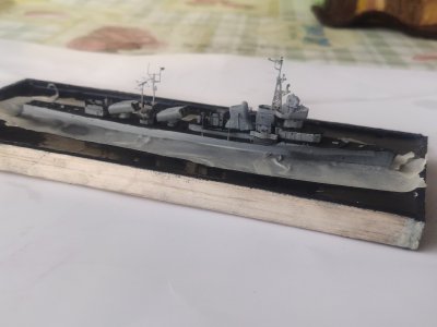

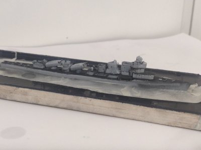

The first I did is to straighten the banana shaped resin hull
had issues how to permanently straighten the hull. A wooden base was made, model was placed on the center and a small amount of resin was poured. It was left dry overnight.
Hull sides were painted gray already. Looks like I have to cover the base before future painting. t

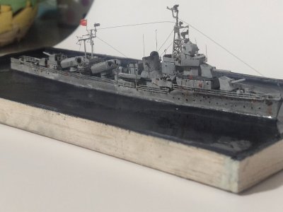

Finally the funnel was added with bit extra detailing according to pics I studied

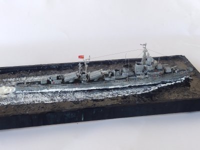

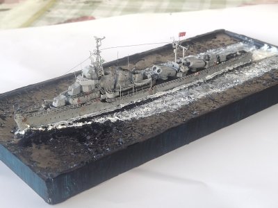

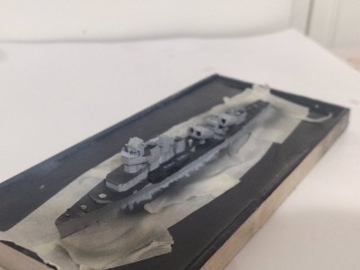

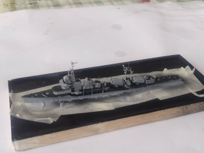

I attached more PE parts mainly platform and few minor ones. Spraying preparation done. Decks were painted with dark grey and veritcal hull surface with neutral grey.

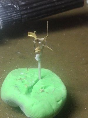

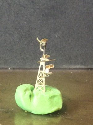

Final work for today, the radar mast, comprised of 13 PE and two resin pieces. Highly detailed is the highlight part of the model
IMG_20260124_113354.jpgIMG_20260125_173846.jpgIMG_20260125_173852.jpgIMG_20260125_174030.jpg

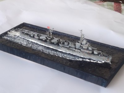

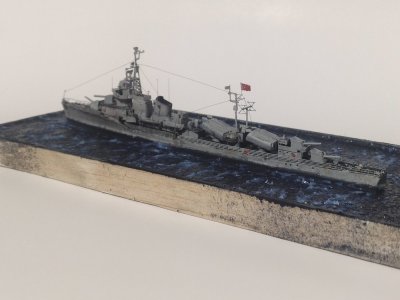

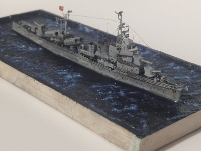

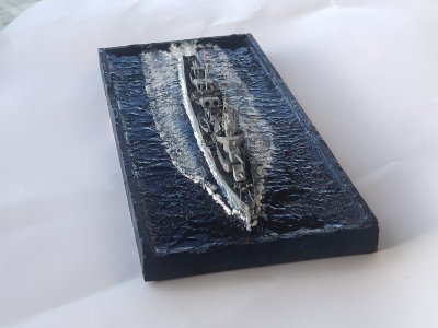

Extra details added. Rails, rigging, weathering. First layer of gel coated wait for it to dry tomorrow to work on the sea surface
