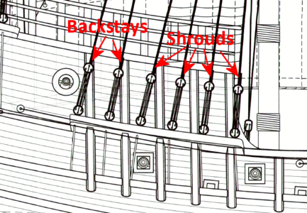

I am building MarisStella's Ragusian Carrack, and have a question concerning the two main backstays on either side. The plans show them connected to the channels in the same way as the shrouds, using deadeyes:

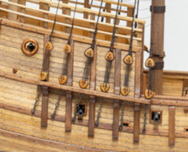

Like Olha, I will be using the older triangular deadeyes:

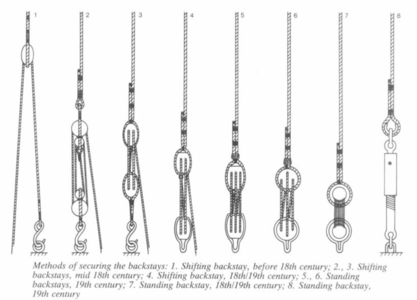

My question is: should backstays in the 16th century even have deadeyes? Zu Mondfeld indicates the following for backstays:
which seems to indicate that deadeyes were not used for backstays until much later. Although possibly that was only for the round deadeyes, not the triangular ones. Version 1, stated as used before the 18th century, is extremely simple (and looks like not much force could be applied), but possibly more accurate? I really like the looks of Version 2 (very different yet older and more complex), but that may be too new a version as well.
What do you all think would be most accurate for this model? I'm not slighting Olha's wonderful model in any way, just looking to possibly include something different.
The paintings don't have enough detail to surmise anything about the backstays.
No one else has an opinion here? I like the uniqueness and complexity of #2 shifting backstay above, even though it gives a timeframe of mid 18th century. Mostly because the "normal" backstay used on other models of this area use deadeyes, which are even later (the 19th century), and the #1 is so simplistic, without any mechanical advantage given by pulleys, seems almost not worth having.
Sources would be great, but I value all your opinions too, so help me decide! :)
