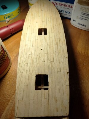

This project is entirely dedicated to gaining the skills and techniques to be used on future projects. I feel that I made a mistake adopting a 40 year old kit where the wood quality was pretty marginal when new. But, I'm invested.
I could use some advice about finishing the Ramin wood deck. I want to learn to produce a polished furniture like finish similar to whatI have seen from fellow members of this site.
Should I try to add deck nailing at this scale. I'm not interested in just scribing marks with a pencil.
What would be a nice way to add nailing
to the deck planking.
I appreciate any help you could pass along

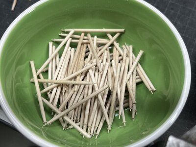

One way of making treennails for the deck planking you can find here (and the following posts):
BTW: when you have a so called drawplate you can optimze the result
I saw Olha Batcherov use super glue but this 40 year old wood is soft and wouldn't stand up to scraping
It is really important to test every time th ereal situation and quality of the deck planking wood.
sometimes, if the wood of the planking is too soft, it is better not to make treenails.
Also on real ships the treenails are often hard to recognize, because they are made out of the same timber like the planks

I like the wire idea. I put a preliminary stain coat on the deck using Watco to protect the finish. The glue I used to apply the finish deck seeped through and the stain is blotchy. Do at this point the only reason to install deck nailing is for the practice.
Maybe it would be good, that you make a test on a some dummy-planking before you start with the treenailing on the real deck
I made a sample and the scale is so small it looks busy. Thanks for your suggestion

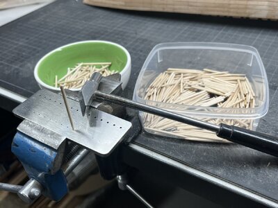

Yup I've been looking at the draw plates and The only ones I've found that have small enough holes are for jewelry making. Would these work
In principle yes - or take a look at the Byrnes drawplate
Thank you, have it on my wishlist
I've read that jewelry draw plates don't work all that well. Apparently because they are meant for reducing wire size they have a tapered entry to the holes and try to compress the wood. I've never tried one myself. It's possible that if you were to stick the wood in the other side of the jewelers draw plate, it may work, I don't know. Just thought I'd mention this so you can approach this with caution. Someone with more knowledge than me may chime in. I made my own by just drilling a bunch of holes in an old saw blade. I got mediocre results and used a lot of small drill bits :)
You are right - the juweliers are using these drawplates from the other side. If you turn them by upsidedown
Important for treenails is only, that one side of the hole is sharp. If you want to reduce the diameter of a longer wooden piece juweliers are not working well (to draw through the hole, you are right, but for a punch / push with the hammer........
Very good working for both techniques is the Byrnes, which I use also
