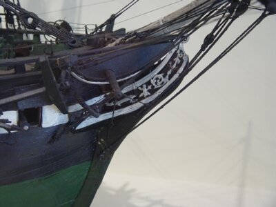

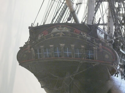

Constitution's transom's true appearance is very tough to pin down. Part of the problem is lack of surviving documentation, part is that Constitution's appearance changed frequently, and part of the problem is that the transom was nearly destroyed in her battle with Java. Java was able to stern rake Constitution during the battle - twice. Since the damage was severe, and initial repairs were made at sea, her rebuilt transom probably looked different than her pre-Java fight transom. What changed and how much changed is not known with any certainty. Some have suggested that the number of windows changed during repairs either at sea or in repairs in port following this battle.
The best references for her War of 1812 fight with Guerriere appearance are most likely the "Hull Model" and the Corne paintings - photos of each below. Her pre- and post-Java battle appearance is probably a bit different for reasons stated above.

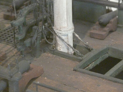

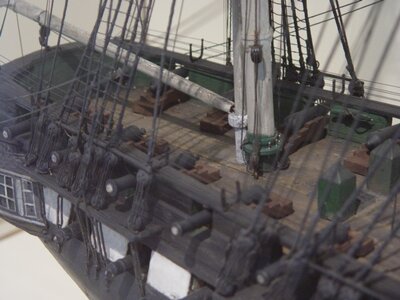

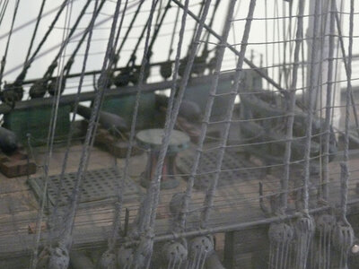

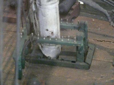

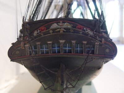

1. The "Hull Model" was built by Constitution's crew and presented to Captain Isaac Hull as a gift. Her crew and captain obviously knew what the ship looked like and the model was built according to that knowledge. The model survives and is preserved at the Peabody Essex Museum in Massachusetts. The model depicts the ship with 6 transom windows. The model is significant enough to be used by the Navy as a source to determine Constitution's rigging configuration during a recent refit. Source:

Note that neither the "Hull Model" nor the Corne paintings show Constitution's name on her transom. Also note that the "Hull Model" shows green inner bulkheads, fife rails, and hatch and capstan trim, and the Corne paintings show the boat over the transom as also green.
Neither the "Hull Model" nor the Corne paintings show any gun ports cut through the transom. As you wrote, that modification came later, under Bainbridge.
The classic Revell 1/96 scale kit's transom is based on the "Hull Model".
