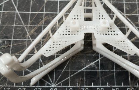

Just wondering. I'm building HMS Ontario and the 3d parts are all gooey and slimy and would have to spend some time cleaning up all the little holes. Is this normal for 3d plastic?
You need to get a stiff bristled brush (I use bulk toothbrushes you can find on amazon), dip it in 99% isopropyl alcohol and give it a good rub down with the brush. This will clean all the unhardened resin off. You can't just dip it in the alcohol and swirl it around, you have to have physical scrubbing.

If these are actually 3d printed resin parts, it's a little disconcerting that they are sending them out that way. First, the resin, in liquid form, is usually quite toxic. Second, if the parts had been properly post-cured, that "leftover resin" would have hardened anyway.

No, that's not at all normal. I don't see anything in the design to cause that and my guess is that they haven't been washed and/or cured properly. An easy test is to stick them out in the sunlight for an hour or two. If they dry out and harden, problem solved. Otherwise, get some IPA (rubbing alcohol) or even methylated spirit and give them another wash, then stick them out in the sun. You don't need to scrub hard, that will just damage the detail.
There are a few reasons for sticky prints e.g. under-exposure during the print (unlikely here); washing in dirty IPA (normal practice is a two or three stage wash, finishing with very clean IPA), forgetting to wash altogether, under-curing or forgetting to cure (but this doesn't usually leave the parts sticky, just a bit soft).
I cleaned it with a toothbrush and alcohol and it's better but not great and I'm not sure what the mesh part is called but half of the holes are filled with resin and have damaged it a bit trying to clear them.
The holes being filled in is down to object design and orientation for the print. That's the tricky part of 3D printing. It might have been better to design this as a 4 part assembly (frame, grating, heads x 2), maybe even more. It's a tricky part to orientate.
I'm afraid if they haven't fully dried out after re-washing and curing, it's unlikely they ever will now.

It is not normal. Did you buy these parts? If so, the supplier did not finish the job. After printing, the parts need to be washed in either alcohol or water depending on the resin used and then cured with uv light. Sunlight will also cure.
