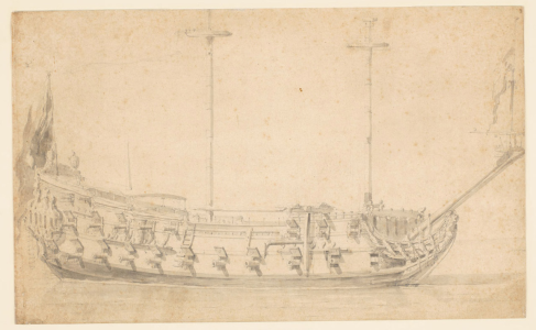

Hello, I have recently been recreating plans according to a drawing of a fourth rate (courtesy of Van De Velde, The Younger) I found in the NMM/RMG archives. However, a problem arose concerning the amount of guns of the actual ships and the depicted ship. (See below)
The ship has 9 gunports shown on its lower deck, 10 on its upper deck, and 3 (though one is likely unused) on the quarterdeck, giving us 18 guns for the lower, 20 for the upper, and 4-6 for the quarterdeck. However, information on the Assurance of 1646, which is said to be the ship depicted, gives a different picture.

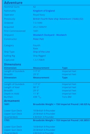

(information from threedecks.org , very trustworthy)
it seems that the lower and upper decks had their gun counts switched, but the description of the NMM drawing further confirms that the Assurance had indeed that layout of guns. That's the first issue.

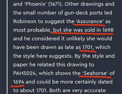

The second issue, as stated in the description of the portrait itself (pictured above), is that Assurance had been sold out of the navy before the drawing was made (1701) - so that makes her even less likely to be the depicted ship - and the second most likely option, the Seahorse, was not even a fourth rate (from what i could find) and was instead a 6th rate of a measly 20 guns. So annoying!

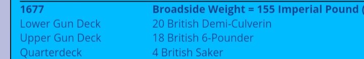

That's when I decided to go look for a ship that might match the broadside depicted and was still in the navy by 1701. The ship I landed on was Adventure, of around 42 guns.
And there on her armament you see:
- 18 guns on her lower
- 20 on her upper
- 4-6 on her quarterdeck
A great match! And it was indeed in the navy in 1701!

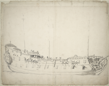

Did you see also this painting?
Portrait of an English fourth-rate, about 42 guns​
A fourth-rate viewed from before the starboard beam. The lower-masts, bowsprits and spritsail topmast are shown. Like PAH3931, this may be one of the 42-gun fourth-rates, and the incomplete upper deck and the triple turreted quarter gallery make it probable that she is one of the early ships, ‘Assurance’ or ‘Constant Warwick’. Although armed like the latter, the beakhead bulkhead is different, and this ship and not PAH3931 may be the ‘Assurance’.
Accurately but rather untidily drawn and probably not based on an offset. It is very approximately dated by the style.
PAH3931 is the painting you showed in the first post
"Your" Adventure is the old one built by Peter Pett in 1646, which was broken up in 1691 and rebuilt
this drawings from van de Velde seems to be from 1673
Interesting to bring up - I hadn't seen it before so this only further confirms that it indeed was not the Assurance being depicted, thank you!

I've also thought about this but, when comparing to the amount of gunports shown on the portrait, the Adventure (after being rebuilt in 1691) was the only ship I could find that didn't exceed the gun count on either deck, or that had too little guns, even if it was on a very tight margin. Along with that, on her established armament during peacetime, she did in fact not use up all of her gunports (losing around 2 guns on either deck IIRC) and many drawings of similarly sized ships often do show all gunports armed (at least when depicting a ship at war) so I think it's fair to say that the gun count matching the amount of gunports is not too inaccurate.
