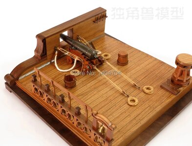

After seeing some of the builds of kits from China on this forum curiosity got the better of me. I have used AliExpress in the past and have not had a problem yet. Shipping is not fast, but is reliable. I bought a deck section kit, with the obscure title "
"2016 NEW wooden scale model scale ancient warship quarter deck 8 pound cannon scene scale wooden military sailing ship models"​
The order arrived after about 20 days, nicely boxed but the cannon kit was wrapped in cling wrap and bubble wrap without a box. The materials were very good. About 20 laser sheets of cherry, plywood of 3 thicknesses, walnut and pear. Very light laser char and very thin cut lines. The cannon is in turned brass and 100 mm long.
The coin is a Canadian Loonie for perspective. Pricing is a bit strange. Several AliExpress stores sell the kit with prices from $153.00 to $69.00 I got mine for $69.00 CND.
I have built the base and added the deck beams.
This is going to be a fun build.
