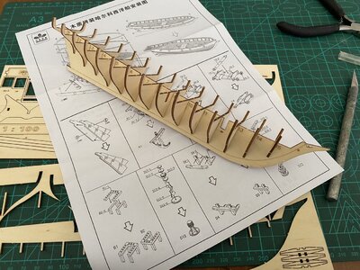

And so it begins...

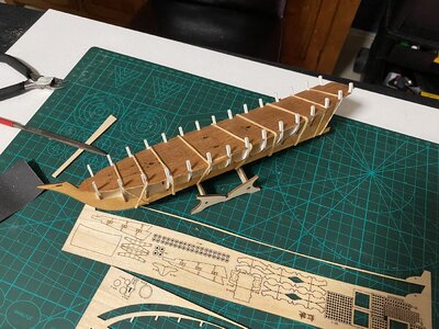

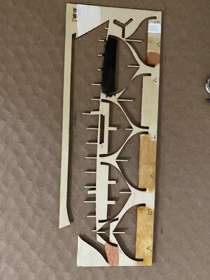

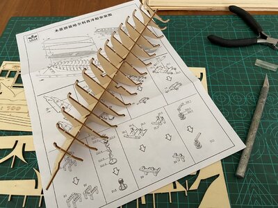

The keel and the ribs (what's their proper name?) all came out cleanly. Test fit was very tight and glued this all up fairly easy.
Although, my glue is an old PVA glue I had sitting around in the garage. It should come out white but was clear. I've used it and fingers crossed it holds ok.
Most definitely buying some more glues, a PVA, some super glue and some contact adhesive. These seem to be what i see most people onhere and youtube using.

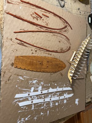

Took the opportunity to do some test painting on some unused wood to see how it takes. Also tested layering my stains, varnish and sanding sealer to make sure they were compatible.
The paint testing went well so I went ahead with pre-painting/staining some parts before fitting

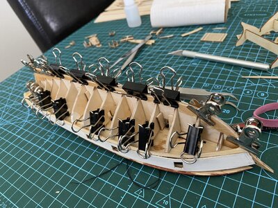

The deck was interesting to get on. The material is quite flimsy and quite a few of the notches in deck the didn't quite fit properly into the uprights.
Possibly caused in part by my pre-painting, but also some manufactured issues.
A bit of gentle filing fixed this, but still managed to crack and snap a coupe small pieces off the deck around the little notches.

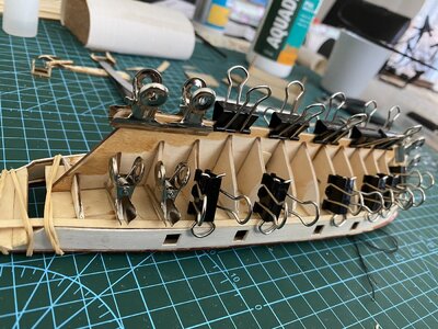

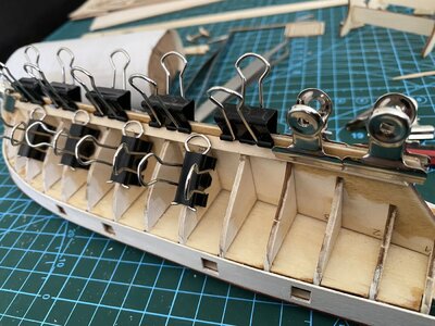

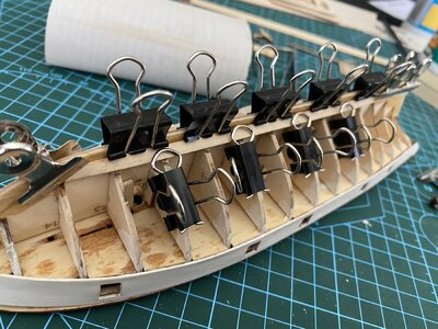

Once this why nice and dry, I test fitted the sides that I had pre-painted making sure the Cannon ports lined up properly. Then once happy I glues and clamped in place.
Pretty happy with the way it turned out. The clamp did mark the bow a little but a touch up will fix that later on.
I also noticed that I didn't bend the very front of the bow in enough and it sticks out a bit, but will keep going and hope this wont present any issues.:

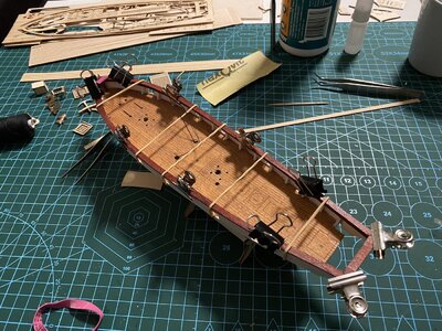

The top rails went on reasonably easily and I really like the stain I applied to them, really pops on the white.

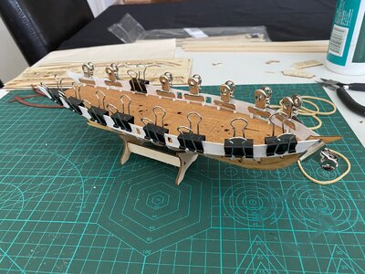

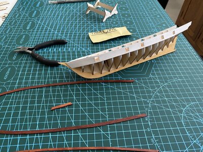

With that all done and very happy with the result I have now begun planking!
I also took the chance to glue some reinforcement around where the masts will sit inside the hull, I got this tip off another Halcon build log.
I also drilled a small hole through the horizontal rib where the Anchor lines will penetrate through the deck, hopefully allowing me later on to pull through a single length of rope for the 2 anchors. You can see a piece of black cotton in the later pictures that i have threaded through at the moment.
Pretty happy so far, although just started.

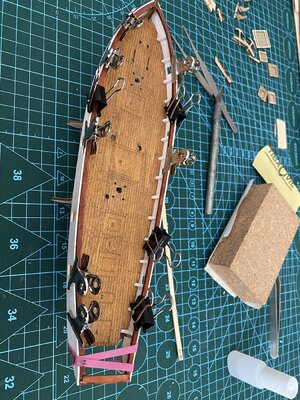

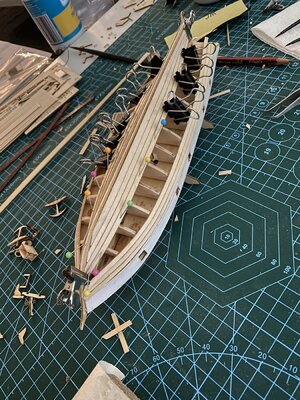

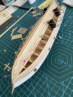

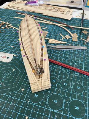

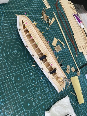

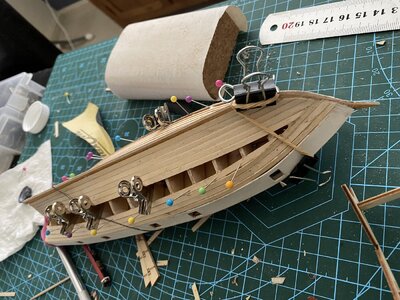

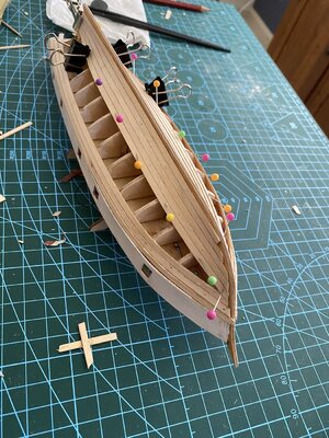

So the planking is coming along reasonably well, I'm pretty happy so far with the results, especially for a first timer.
Had to resort to map pins to hold the planks down in some places, as I couldn't get the clips into a good enough position to hold the plank down whilst drying. I am hoping that after a light sanding these will be hidden well enough as my plan is to stain and varnish the hull. The planks meeting the bow also isn't particularly neat, but I am hoping to fix this up as much as possible with a bit of surgery and when sanding after planking is completed. The last couple of planks applied I have begun to notice that there is a fair bit more vertical bend required. I am going to apply the next planks as partial length and let them lie naturally across the hull and cut to fit.

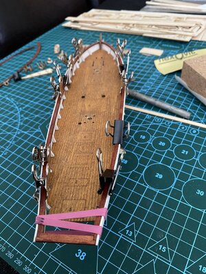

I have also been chipping away at putting together the various small deck fittings between plank drying times. I did manage to bust one of the edges of a grate, totally and also have dislodged the top of the handrail. The grate edge, I guess I will have to live without it and try to hide it somewhere/somehow. The handrail I ended up totally removing it and will glue back on at a later stage.

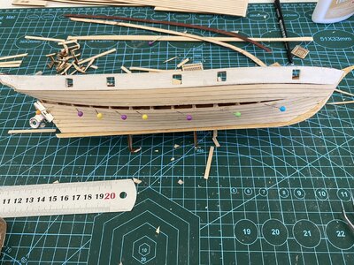

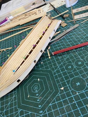

Next step will continue on with more planking, hoping to finish this stage in the next week or so. It appears I am now at the stage where the planks will require some shaping to fit and will probably have to apply some partial length planks as well to reduce the vertical bending stress on the planks and glue.
The planking is coming along well, my trimmed pieces are fitting in nicely. I really think this will come up well after a light sanding, stain and varnish.
