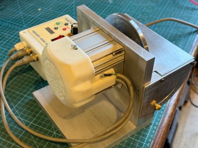

As I am about to launch into making a scratch built 74 gun ship, I felt the need for a good quality small disk sander. On checking various vendors, and searching the topic in SOS, YouTube, and Google Images, I decided to make my own. Having recently made a drum thicknessing sander and being very impressed with the 750w AC Servo motor and controller from AliExpress, I ordered another identical motor with controller, and sat down to design my own disk sander.

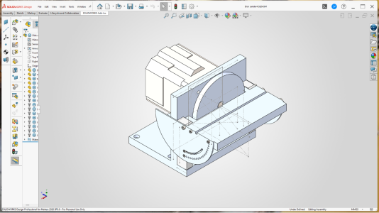

I was heavily influenced by the solidity and simplicity of the Byrne sander, and spent quite a few hours with Solidworks to put my own ideas into a design. See the first photo.

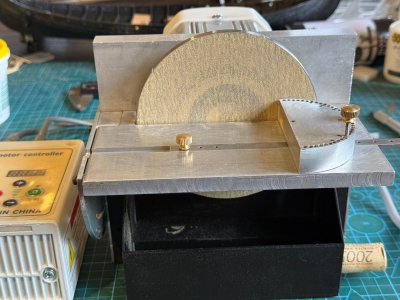

The making involved accurate marking out, milling, lathe work, and modifying designs as I proceeded. I ordered some adhesive aluminium oxide 125mm diameter sandpaper disks from AliE, and waited until they arrived before finalizing the design.
The photos are the almost finished machine. If you are interested in the details of the machining look at recent posts on my blog, johnsmachines.com
I still have to make a dust extraction port and dust collection well, so there will be one more workshop session for that.
Apart from the motor, controller and sanding disks, all materials and parts came out of my workshop. Total cost was $aud200.

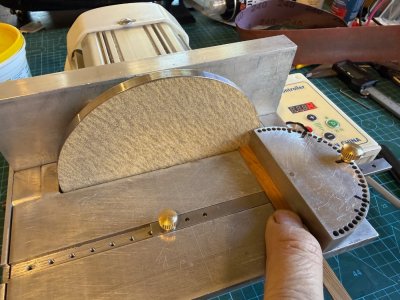

The table tilts to 45 degrees in 5 deg steps and also continuously. The protractor fence is a hemi circle also in 5 degree steps. The angles are accurate to within a small fraction of one degree. I can run this machine from 200 to 2000 rpm without any need for bolting or clamping the base. Above 2000rpm it does need to clamped to the bench.

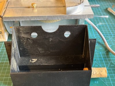

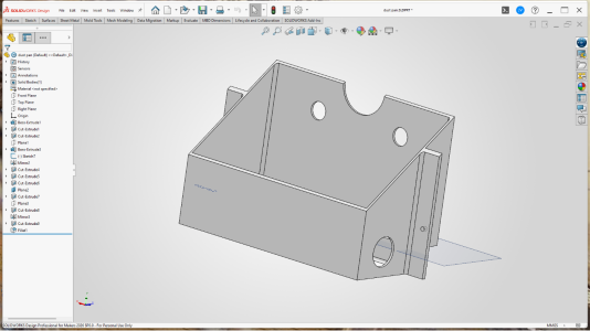

Yes, your comment prompted me to get on with it. I decided on a 3D printed dust pan, with a hole for a vacuum outlet. 3.5 hours of printing with a QIDI filament printer. Works well.

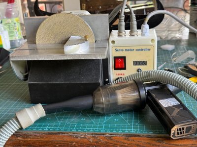

One more development... Now the dust box has a 3D printed lid to increase the air flow around the sanding disk. And the vacuum unit is attached. It is an inexpensive Chinese battery vacuum/blower, which works well on its lowest (and quietest) setting. Cost $aud20-30. The hose is off an old CPAP (anti snoring) unit.
