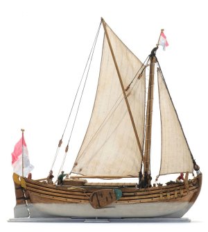

I’ve chosen to build a narrow ship. As described in Ab’s book.
And it should look like this:
It’s not a large model—only 22 cm across the stern—and it’s on a 1:77 scale.

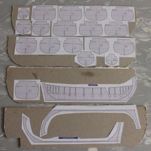

It starts, like many building projects, with a false keel and a number of transverse frames. I cut these out and glued them onto a piece of 1.3 mm thick cardboard.
The bottom two strips are intended to thicken the false keel, creating a rebate between the frames and the false keel so that the skin covering will fit into it later.
