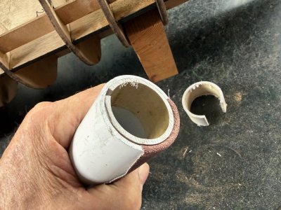

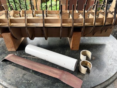

1. Bellerophon bulkheads ready for bevel sanding. I cut some 1.5"/38mm PVC pipe about 4-5 bulkhead spaces long. In this case 220mm.
I also cut 2 rings about 20mm wide from the same material, then removed about 1/4 of the circumference so the cut rings will compress to fit inside the ends of the pipe. Then cut some 50mm sandpaper about 50-60mm longer than the pvc pipe.

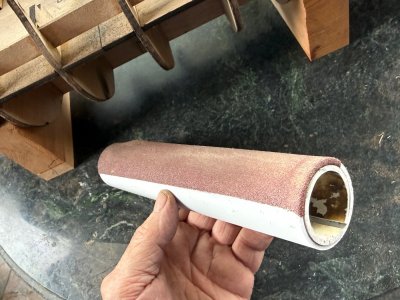

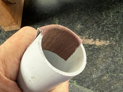

2. The sandpaper is stuffed into the end of the pipe and massaged to fit snugly. The paper is used, but still has some life....it is out of my drum sander.
3. One of the transected rings is compressed into the end of the pipe
4. Same at the other end.

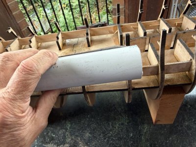

5. And there is a perfect sander for beveling the bulkheads. It fits into the tumblehome shape and the concave section adjacent to the keel, and also to the convex areas in between.
The expanding surclip type inserts hold very securely, and can take a bit of force to remove. I like the length and diameter for my Bellerophon, but the size of the sander can easily be scaled down for smaller models.
