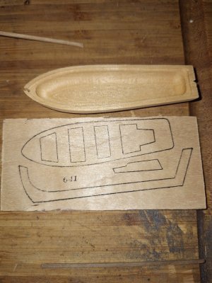

a tiny saw to cut out parts drawn on sheets?
Apologies, I figure there's a precise term. I've been running an xacto blade over and over the lines but it just seems to take forever. Is there a recommendation for some sort of iddy biddy tiny saw to cutout these sorts of parts?

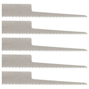

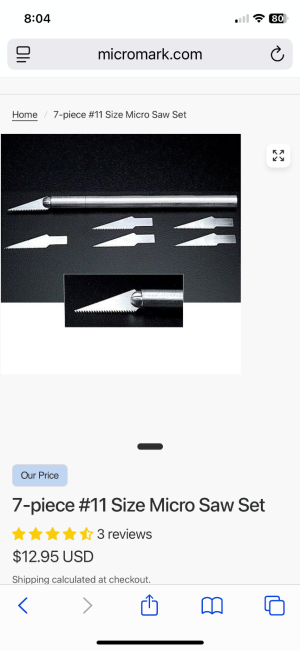

zona saws are very thin and fast cutting. ive used them for guitar building n fret work n cutting inlays
they have a nice assortment of saws...
edit...
i found they sell replacement blades here...

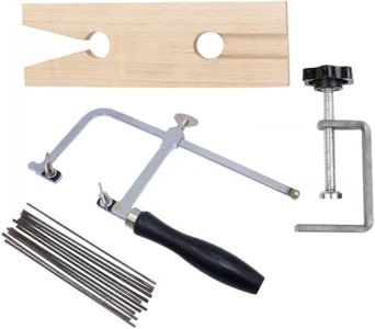

Jewellers coping saw is the simplest option. Faster to use than you might expect and highly controllable, with a little practise.

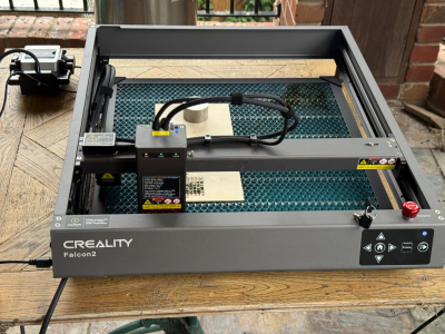

If you can draft in CAD, then the other easiest option is laser. An inexpensive 5W laser will cut thin pieces of most hardwoods used for ship modelling.
I have used all of the options listed above and all are reasonable.

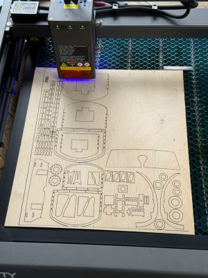

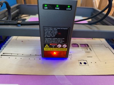

But recently, having a need to cut out several hundred parts, from materials varying from 0.5mm to 6mm thickness, to make a 1:72 HMS Bellerophon, I purchased a laser cutter. I chose a Creality Falcon2 40watt machine. Admittedly a more expensive option than those listed above, but a quantum leap in quality and speed of cutting. And it does have a learning curve. The ability to make fast clean accurate cuts, either full thickness or partial thickness, for me is a game changer.
BTW, I still use the simpler, older, conventional methods as required.
The Creality machine which I chose will cut up to 16mm thick MDF. And up to 0.25mm brass and stainless steel. The parts in the 3rd photo were cut in about 15 minutes.
Just saying.....
These machines are a great leap forward and are rapidly coming down in price. They do admit a lot of smoke, which is probably toxic while they are cutting. These machines should be used outdoors or in an open garage. Alternately you can purchase an enclosed using and duct the smoke outside. There are many you tube videos that go into great detail about using these.
