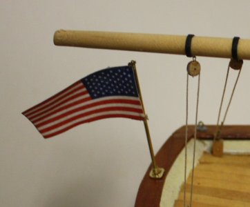

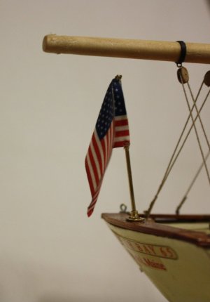

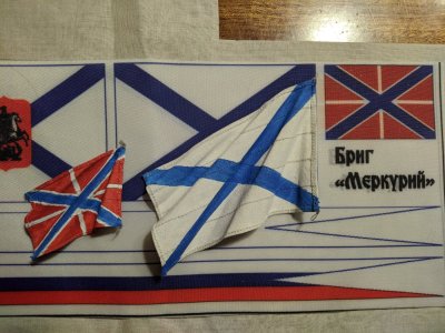

Thank you for the suggestions and wonderful pictures. All your flags look great.
