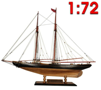

Dear Bluenose builders,
As some of you might know, I'm currently in the final stages of rebuilding a Billing Boats Bluenose model my father initially build.
During this process I came to realize, partly due to the visits I paid to this website, that I want to build a more authentic model of the Bluenose.
Of course my attention was drawn to the various POF build logs on this website and became impressed by the beauty of the YuangQing model.
But... My experience is limited to 2 POB models some 40 years ago (BB Lilla Dan and AL Scottish Maid). So I'm rather reluctant (or just having cold feet) to just go ahead and order and start building this model.
What really is bothering me is, that apparently some of you ran into issues with broken frames, because their construction is not rigid enough to handle "building" stresses. So, what's more lurking under the surface?
So what would your recommendations be? First built for instance a Model Shipways POB kit, prior to embarking on a POF build? Or just go ahead and embark on the POF journey? Bear in mind I'm at best an advanced beginner...
Thanks in advance for any thoughts you may have.
Johan
