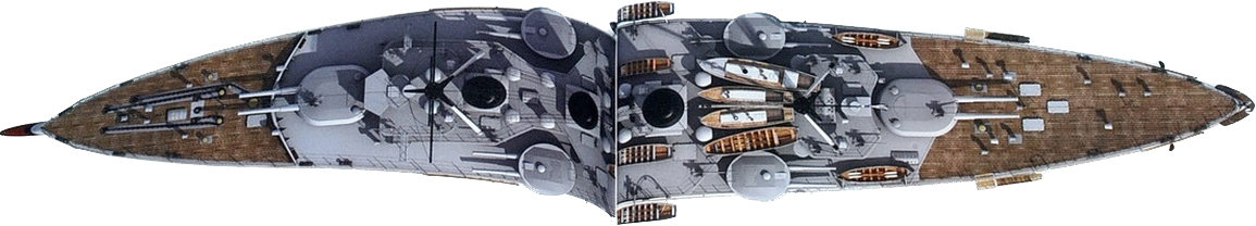

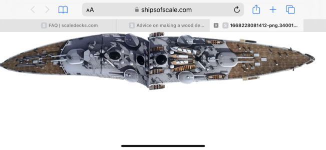

I have a resin YS Masterpieces,1/350 scale Georgios Averof that I am considering placing a wood veneer deck on. As I am inexperienced in wood crafting, my thought was to purchase a generic sheet of decking in the scale and custom trimming the veneer to match the fore and aft deck areas, i am concerned, in particular, about cutting out the areas for the deck fittings If anyone has experience with this, I would appreciate your help.1668228081412.png
I have a resin YS Masterpieces,1/350 scale Georgios Averof that I am considering placing a wood veneer deck on. As I am inexperienced in wood crafting, my thought was to purchase a generic sheet of decking in the scale and custom trimming the veneer to match the fore and aft deck areas, i am concerned, in particular, about cutting out the areas for the deck fittings If anyone has experience with this, I would appreciate your help.View attachment 340016
Pictures?

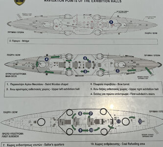

HE3890AD7-8157-40F1-B859-3E6FDB22EC82.pngere is a picture of the fire and aft decks taken from a book I have. I can supply more if necessary

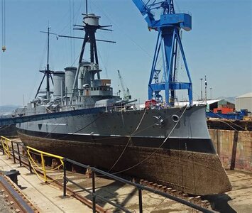

This was taken while I was on the ship recently This plan most accurately depicts the deck plan. The areas amisships and the superstructure are steel decking 8A0F9149-CC39-484B-A3C4-C883921EE3A6.jpeg

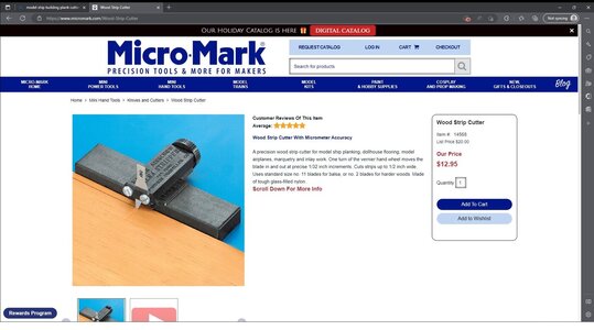

If you are going to use veneer, it will need to be cut into strips. Use a strip cutter if you can. Cutting opening will take some measurements and a sharp X-Acto with a #11 blade or maybe even a scalpel. Start amid ships to layout the centerline and plank then go from there, cutting and fitting each strip to fit. Some sanding and shaping may be necessary.Strip Cutter 1.jpg

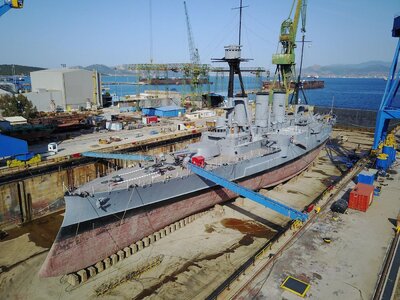

Regarding the Averof, I have another question. I have seen the hulls on models painted several ways. Also photos of her during her last dry dock show the hull repainted black. Reference drawings show a red hull with a black boot.
My question to those familiar with the Averof is: was the hull painted in hull red with a black boot topping, a solid black, or perhaps as I have seen some Italian ships hulls done in a green with black boottop.

Make a paper template or two until you achieve a near perfect fit. Once satisfied use the template to cut out the the generic veneer. You only have the stern and fore sections so that should be easy to fit. Green antifouling was exclusive to the Italian Navy. The ship, a Pisa-class cruiser like her Italian sisters Amalfi and Pisa, was built at Orlando Shipyards at Livorno in Italy so it would be appropriate for her to have had green antifouling when purchased by the Hellenic navy in 1910(?).
9A282EDA-D441-4B38-8D53-86570A0C2BE9.jpegI felt that I would try to practice cutting the deck with card stock of similar thickness to the veneer, so as not to waste experience veneer. As for the hull color, I had considered green as being the first color on a new Italian built ship. Then I came across these pictures of the 2017 refit once the hull was cleaned, red was her last color prior to being redone in black, ergo I am perplexed as to the color I should go with.

Handsome ship. - Looking at those photos obviously of a recent refit I'd use Black for the Boot Topping and standard Red Oxide for below the waterline antifouling. If you wish 1910+ scheme Light Ash Grey, Black boot Topping and Green anti fouling. Cheers.
I feel using plastic card and wood veneer would raise the deck profile too much.
Regarding the hull, I believe the color will depend on the era I choose to portray her in.
If I can produce the cage aerials effectively, I’ll shoot for the 1920s paint scheme. Otherwise I will probably go with the early green hull
