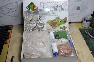

The unboxing:

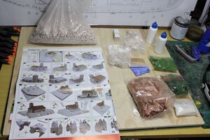

Open box
The kit contains all the parts you need plus the glue.
You need to supply the tools ( For the actual model builds a sharp No 11 cutter, pair of scissors and nail file boards.)

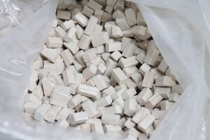

The contents consisted of a bag of miniature bricks, Roof tiles, Paving , grass, bushes sand & dirt, ( I will not be using the blue river sand!)

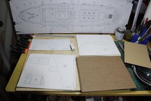

Aldo there is two a3 sheets .
Three sides of the sheets contain the step by step plans for each of the buildings, plus general instructions on how to to do things. These are in multiple languages including English.
Lots of bricks
Next there are the cardboard sets for each of the builsings as well as hardboard bases for the four sections.
Also supplied are cardboard tabs to attached the building parts

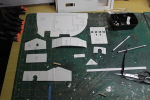

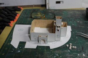

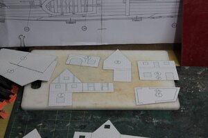

First thing was to follow the plan page & press out all the parts needed for the first building
This was very easy as the base & the parts needed are all stapled as a single item
The only section that needed to be cut by hand was the window & doorways. These were stored & labled for size ref for door & window shutters later

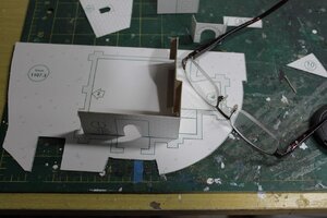

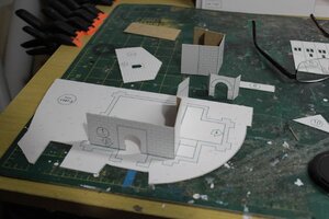

As this is a multi level dorama, the first base was cut ready for the building to be mounted
The building was then placed on the marked lines and glued into place.

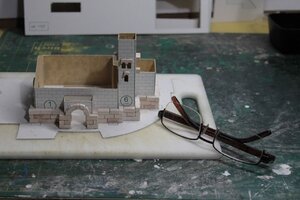

Note the size in comparison to a pair of glasses ( These are NOT large buildings)

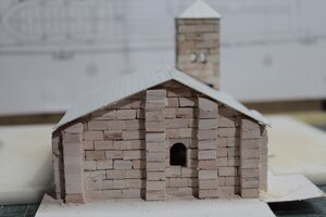

The buisng was then completed to the wall only stage as suggested

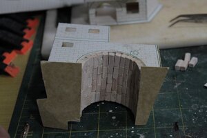

Next the brick work commences:

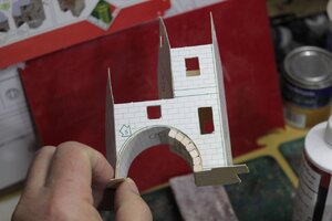

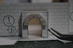

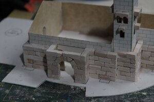

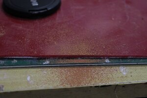

Archway parts are provided in this kit, however they do need to be shaped to fit with the nail files ( Brick is a very sandable product, but does need to be done over a container due to the dust.

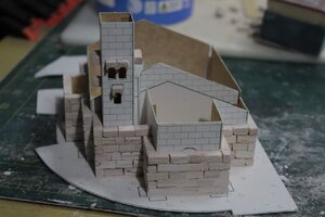

The wall layering commences. Note you need to build from the corners out to get correct wall edge alignment. Some shaping is required to get a correct fit, however the brick sizes vary and most of the time with a little trial & error they line up.
Once you have a wall side layer of bricks test laid & selected they can be glued into place with PVA. As per any brickwork they must be staggered.

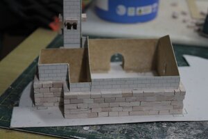

The bricks ( in this scale huge Slabs) are slowly added around the perimeter of the building( carbo00ard walls). The bricks come in two major sizes - ( I call them normal and a bit longer.) The normal and a Bit longer vary a lot in both size and width and condition, so its a pick and choose to fit.
In some instances they require a "Brick Bolster" ( no 11 blade) to break to a smaller size ( this normally results in an uneven cut that needs to be sanded to size and flat. ( Anyone who has done Brickwork - Paving etc will understand( its just in miniature). Your fingertips however look jut like normal brick laying hands!!!)

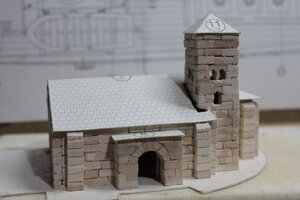

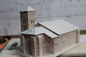

Once you reach the top of the was, they are left until the outer roofing walls are done and once dry ( overnight) sanded down to the roof line and beveled on the edges. This is to allow the roof to sit correctly.
Roof added

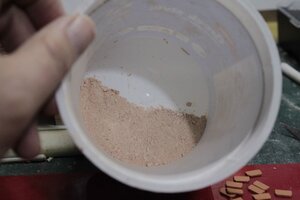

The risers were then sanded straight and all the walls given a light sand to make the surface flat and even.
Al least you end up with some nice dust for hole filling & pathways

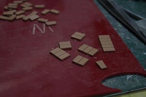

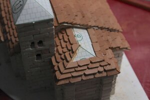

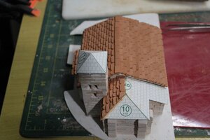

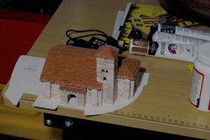

Next the roof tiles are added.
They are flat clay and need shaping.
to this
and you get this

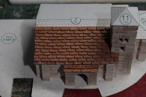

They are then added to the roof from the edge up. They can be nicely lined up with the lines on the roof. This is a SLOW but satisfying process and anyone who has done coppering will relate to it.;)

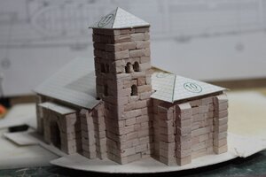

1 down 6 to go
First building finished. Hardest part the little roof of the tower as the final sanded roof tiles were very very small to sand.

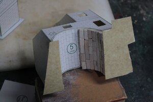

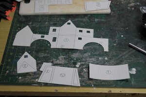

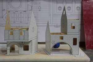

This building consists of two separate buildings with angular walls, overhangs & arched walkways.

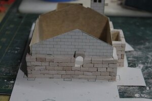

Arch finished & on to the funny angle walls.
