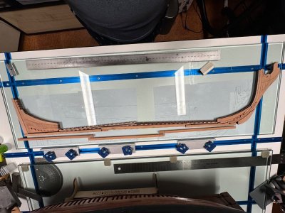

I had been thinking for a while that a building table with T-tracks would be very helpful for this big project.
I bought a pre-made Melamine T-track board 1" x 40" x 26" from Rockler with a few clamps and accessories to fit on the rails. Rockler has a multiple clamps and devices that slide on the rails.
First order of business was to secure the T-track board on my building table with double stick foam tape and organize the shop for the new build.
Next, I put the keel plan between glass panes to smooth it out. The keel structure will then be assembled followed by the building jig.
The sheets containing the parts forming the keel structure and the parts themselves are very clearly marked. The wood is top quality, and the laser cuts are perfect, cutting completely through the sheet. The plans are very good, with parts' numbers clearly marked; I have the instruction manual on my I-pad right in front of me.
Next I will remove the keel and apron parts from the sheets, and clean up the laser char.
Once detailed and dry-fitted, the keel parts will be glued with a glue stick to the plan and assembled using wood glue.
The keel structure will then be sandwiched between two glass panes. while the building jig is assembled
Here is my new building table with T tracks !

Hey Alex ! Welcome to the group build !
I love the building board with the T-tracks. I had thought about doing that but just decided to use a sheet of high quality plywood to attach the building jig to. I'm following your build so I can see what others do differently. :)
Never thought of using T-tracking, but it sounds like a great idea. Thanks for the post about this and how you set it up.

Great start, Alex. I, too, have looked at that same pre-fabbed T-track board, but wasn't sure about how effective it would be. I will eagerly follow your build and your review of the T-track board application.;)
