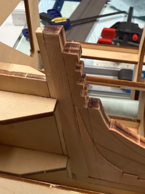

So far, the joinery with the graphite-laced yellow glue is strong, but the color is more grey than black, and I don't want to add more graphite to it; I will try the art paper sometime later on this kit. I see you have a T-track table...and you are using it. Do you like it ? so far, I love mine-very practical. Is your kit the CAF Enterprize? mine is the Dockyards' 1:48..Enterprize. Your stem is of a different construction, but similar shape, to mine. Nice joinery.FWIW, I have always "suspected" the graphite powder may weaken the yellow titebond from test pieces I ran tests on. My end result is using a very porous black art paper between joints. when glued, it is quite thin, and yields a strong joint, IMHO, quite realistic. The big plus..... when hit with glue, both surfaces, just enough to fill any tiny void giving nice finish. When dry, very easy to simply chisel away from wood.View attachment 511662View attachment 511664

Sorry for the confusion, the T-track images are of my scratch Euryalus, only to show the paper joinery. If you have an art supply, this paper is a very loose, porous weave, you can literally pull it apart , but it compresses and gives nice result.So far, the joinery with the graphite-laced yellow glue is strong, but the color is more grey than black, and I don't want to add more graphite to it; I will try the art paper sometime later on this kit. I see you have a T-track table...and you are using it. Do you like it ? so far, I love mine-very practical. Is your kit the CAF Enterprize? mine is the Dockyards' 1:48..Enterprize. Your stem is of a different construction, but similar shape, to mine. Nice joinery.

You are quite right. Graphite has a laminar flake structure at heart, and the laminations on the graphite will fail before the glue. Carbon Black, or black powder paint would be a better choice.FWIW, I have always "suspected" the graphite powder may weaken the yellow titebond from test pieces I ran tests on.

I jlooked at the build carefully and I did not miss a piece or made a mistake ( not know what I don't know) just sanded down a piece of spare wood to fill the space between the jig stern support and the sternpost. I don't like gaps, and this piece will just add support
to the keel. The second picture shows the sternpost and the new support piece from above. The sternpost is tapered and sanded down to 3mm.
