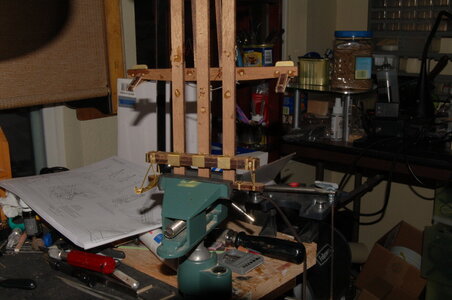

I have used the following so far
1. CA adhesive(thick-medium set time). Especially for metal to wood and metal to metal
2 insta set(when needed)
3 UN-cure for those CA mistakes
4 Nails from old ship builds because the nails with is kit are sometimes too large or too short. Seems like .5 and or .7 mm work.
5 Small HSS drill bits 1mm and less
6

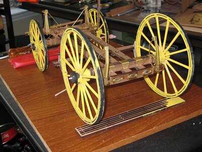

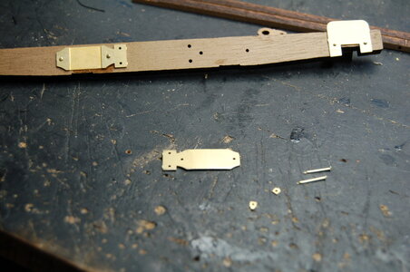

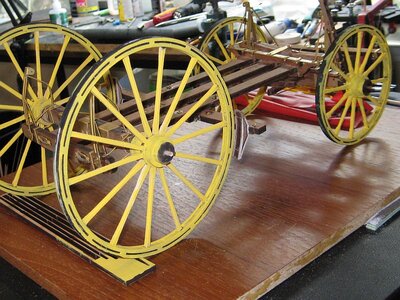

DSC_1149.JPGDSC_1150.JPGDSC_1151.JPGDSC_1153.JPGDSC_1154.JPGDSC_1156.JPGDSC_1157.JPGDSC_1158.JPGDSC_1163.JPG
OK Sorry for abrupt end to last post. The latest Win10 update killed my keyboard. Fixed now.

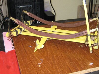

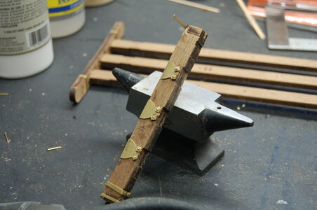

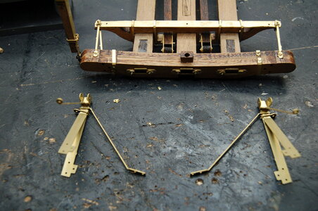

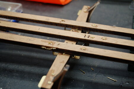

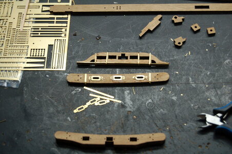

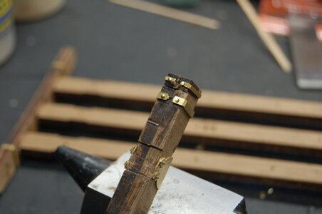

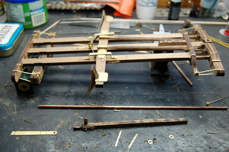

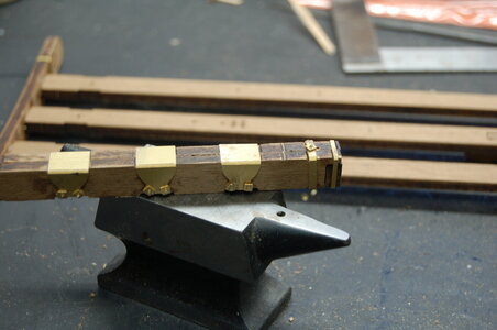

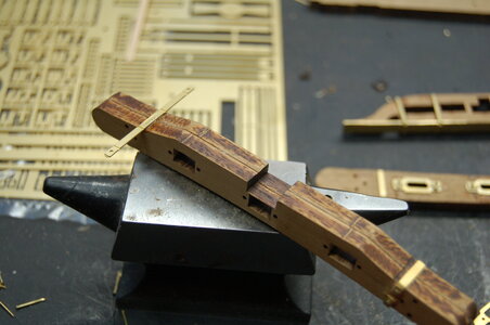

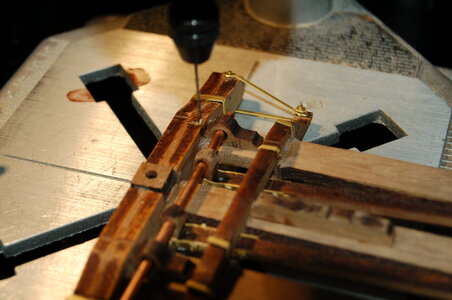

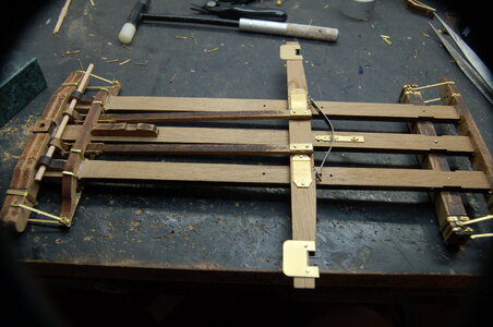

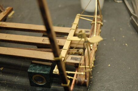

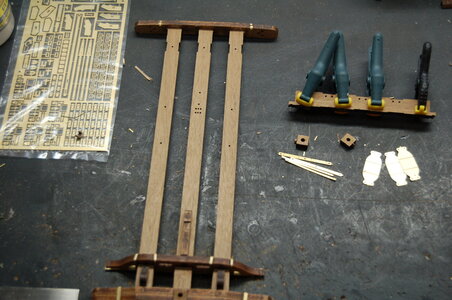

This kit has very high quality materials, especially the etched brass parts. If you note the builder even etched bend lines to help make 90 deg bends. Caution. If you bed the wrong direction, you may have one or two redos before breaking. Study direction of bends closely. It is easy to get it backwards. The kit uses small parts that look like nuts. Does not say which ones to use on each connection Some holes in brass parts are too small. Mostly just need slight enlarging. On some install of brass parts had to use vice and Dremel drill press. My Dremel 2050 started wobbling the bits so I replaced it with a battery powered one. Drilling a hole through the brake cams and copper tube eluded me. I resorted to CA. Also may have brake shoes on backwards. Having trouble posting comment under pics. I Will work on this and post more later.

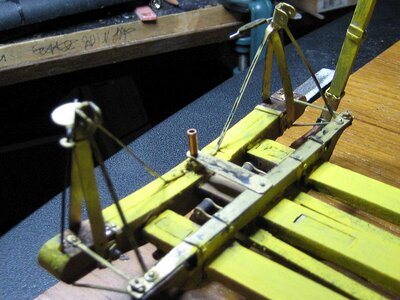

By the way, directions say to paint frame bright yellow . I think brass on wood looks better. Wonder how long that yellow paint lasted on the road?

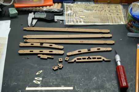

Don't forget small bracket on each side as it will be needed to help attach body to frameDSC_1173.JPGDSC_1183.JPGDSC_1184.JPGDSC_1163.JPG

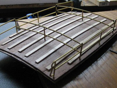

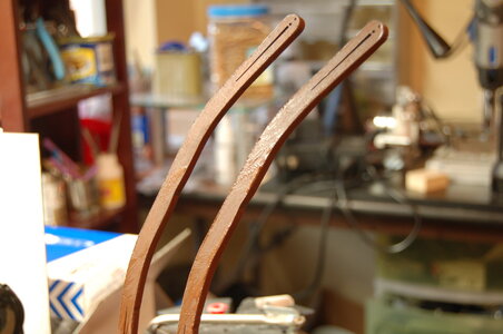

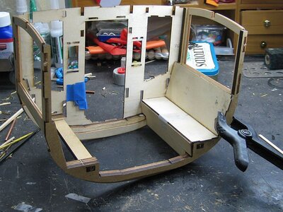

So sorry for the huge delay in further posting. I have finished this build and I believe it is one of the very best kits out there today. If you are precise in dimensionally following the drawing, Every thing fits with out a lot of sanding and filing. (a few holes in some etched parts will need enlarging and some nails in kit are wrong size) I . I will post rest of pics next week. Next project is Rucker ambulance(US civil war).
0
Well better late.........

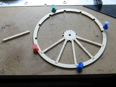

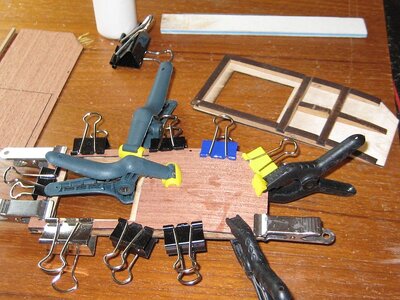

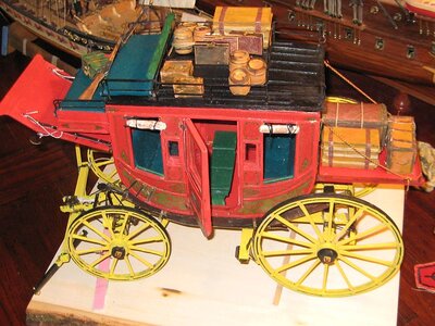

I am enclosing a few of the pic I made of this build. I have many more, but since there are excellent Amati build videos on you tube and I don't think anyone is following this old build, I will close out. This is one of the most enjoyable kits I have built
Great fit,instruction and quality
If anyone wants any input from me on this build, let me know. There a few gotchas, but only a few.IMG_0539[1].jpgIMG_0552[1].jpgIMG_0554[1].jpgIMG_0559[1].jpgIMG_0564[1].jpgIMG_0568[1].jpgIMG_0583[1].jpgIMG_0590[1].jpgIMG_0610[1].jpgIMG_0615[1].jpgIMG_0539[1].jpgIMG_0552[1].jpgIMG_0554[1].jpg
