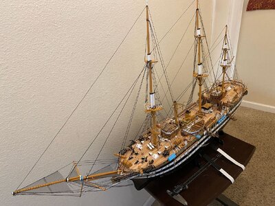

I finally finished installing all three masts plus the shrouds, rat lines, and the fore and aft stays. Can no longer avoid starting the spars. I welcome any prayers that it will go easier than I am anticipating!
Very good looking model - crossing the fingers for the work on the spars
Well done Mantares
Thanks. How is your progress coming along?
I'll do the three main spars first as it looks like the instructions are fairly complete for doing them. Perhaps after building a main spar, the other 4 will become more evident how to do them although I have spent a lot of time looking at the plans so far and not getting a lot of help from them.

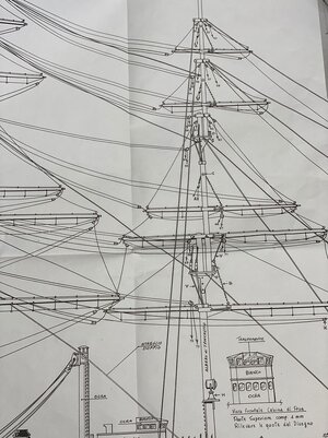

BTW I highly recommend purchasing the Amati Amerigo Vespucci plan set. How to do the rigging is quite clear. Best of all it shows how the upper spars are attached. I'm enclosing a photo of a portion of the rigging plan. I purchased the plans from Cornwall in England for a very reasonable price, under 13 pounds or about $30 to get in the U.S.
You will need to translate the Italian if necessary.
If you are mounting your spars you have probably found that mounting the two lower spars is described in the Mantua plans so, with the Amati plans describing the upper three spars, we now know how to mount all five spars. It took me a while to figure out but I finally found that the "top" yard (second yard from the bottom) Is basically attached the same way as the yard at the bottom. I inserted a small piece of tubing so that the yard was pivotal in the same manner as the bottom yard, The plans just show it glued in.

Unfortunately, it looks like Cornwall Motor boat isout of stock for the AV plan
I'll check again in a week or so
The plans are available at several places in the US at around $30. With shipping cost is probably a lot cheaper to wait to get it from Cornwall.

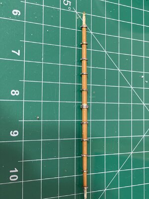

Here's a picture of the topmost main spar with just the rings installed.
One huge advantage of these rings in contrast to the laser cut ones is that they can be made to fit the spar. This alleviates having to make the spar precisely to fit the rings. It's a lot easier to make the rings fit the spar after just making the spar look good without having to make a lot of measurements while working on the lathe. I form the rings on a steel dowel and then tweak them after to make a good fit. You can wind the wire around the dowel several times to make multiple rings at the same time and then cut them apart. I purchased a set of dowels in increments of a half mm so that you can adjust the ring after winding them usually only slightly to get a good fit.
Received my plans from Cornwall model boats this morning excellent exactly what is needed.
Very lucky I looks like I had the last one of the current stock.
Thank you for the heads up.
