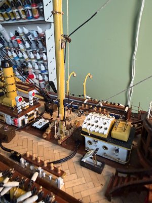

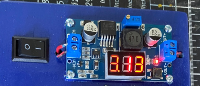

I began the build of my OcCre Amerigo Vespucci April 1st last year. When preparing for the build I wanted to use some artistic license in changing some of the kit instructions. The biggest change was to add lighting to the ship to have it resemble the actual ship in port at night. I decided to run 4 separate circuits through the ship that would be controlled by switches I built into the base. I wanted two separate circuits for the cabin lights. Some could be on while others off or all on. I wanted a circuit for the deck lights. And a circuit for the distinctive green, white, red spot lights that represent the Italian flag to shine up into the masts. On this circuit as well are a red and green navigation lights mounted on each side at the bow and a yellow on the stern. Inside the base I have voltage regulators that protect the LED circuits that receive current from a block instead of batteries. Having a LED burn out deep inside my ship at this point would be disappointing.

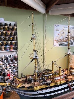

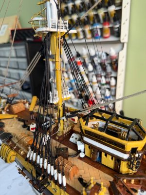

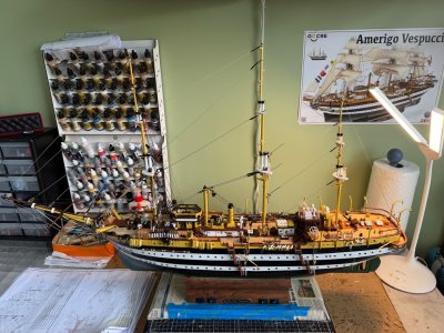

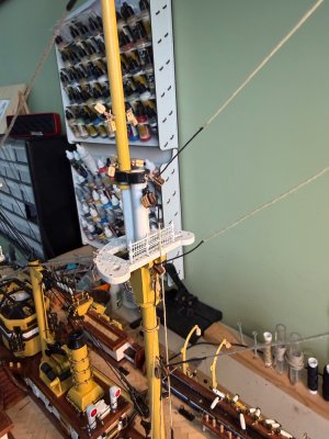

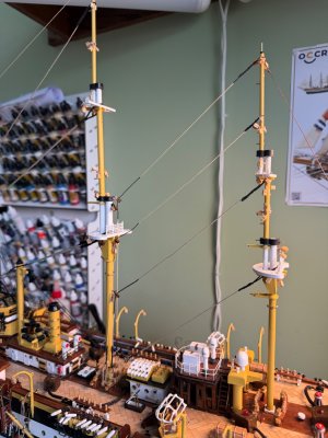

So here is a bit of an update on my recent progress with my OcCre Amerigo Vespucci with a bit more artistic license used. I have started the standing rigging. On the actual Amerigo Vespucci white or very light color rope was used for the stays. This helps capture the green, white, and red colors shining up from the deck. On the actual ship black rope was used to serve the ends of the stays where they wrap around the masts and at other locations where the stays interact with blocks, deadeyes, etc. I decided to replicate this design by using light beige rope of 3 different sizes as I moved up from lower to top of the mast. I then served each of the stays at the different points where they contact a mast with black. I also changed the rigging from what OcCre instructed. In the instructions the stays are tied at the beginning and end to eyebolts. I preferred running them down to tackles on the deck where they can be tightened or loosened. I have yet to tie them down permanently until I complete all the shrouds. Then I can fine tune all the lines just like tuning a piano.
Reached what I usually consider a milestone once I start rigging a ship I am working on. Today I hung the last stay on my Amerigo Vespucci. As I mentioned before I am using light beige rope for the stays instead of a dark thread usually used for standing rigging. Since I have installed the LED spots that will shine the tricolor Italian flag up into the masts I wanted to capture as much of that light as possible by using light colored rope. This what is used on the actual Amerigo Vespucci. For contrast I served with black thread all the ends and contact points of the stays. I have not tied them down permanently yet or trimmed loose ends. I will do that after all the shrouds are up and I can fine tune the masts alignment.

What is the purpose of the control boards that you have installed beside the switches?
