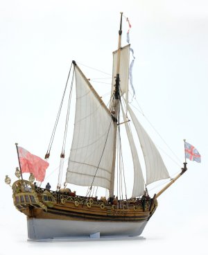

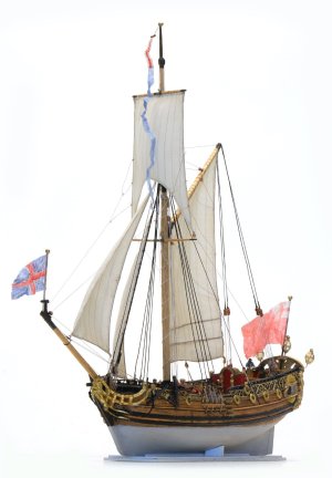

An English Royal yacht
Pretty, pretty, pretty!!! Bravo!
I love the simple elegance of English yachts of this period.

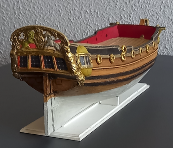

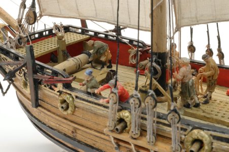

I am curious how you did the stern and gunport gold decorations (paper? Wood?) Apologies if you stated it above and I missed it.
Thank you @Bluemaxone, on behalf of the English shipwrights.
For the decorations I used anything I could lay my hands on. Magic Sculpt for the bigger decorations, gesso for the smaller ones. The gunport decorations were on a basis of paper with here and there blobs of glue mixed with some chalk. It's not really carving, it just looks like it (I hope).

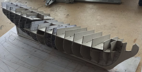

Your remarks are very kind and you are probably right, but it feels a bit like injustice towards all those hard working wood and metal-builders, creating their models that last for years to build, slowly progressing towards the end, puzzling how to make their next move. I mess around with scissors and glue for a few weeks and I am satisfied with these easily obtained results. It's not a really fair comparison.
In fact it all depends on what one is building for: is it the result or is it for the proces of building?
And actually I am fully convinced that the material used is of no relevance: be it wood, metal, paper or Lego. We are all after the challenge to create something that was not there before.
One can be astounded about the results, but everyone sets his own standard (IMHO).

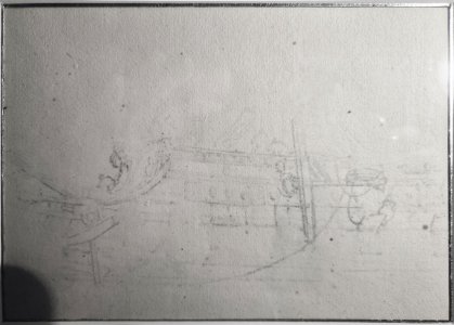

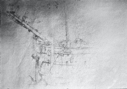

Hi Ab, your work is incredible, especially considering the simple materials you use. On another note, while the yacht is an interpretation, I noticed you started from a plan. What vessel is it based on? Perhaps the HMS Fubbs? Thank you very much and congratulations!
Best regards and congratulations!
Thank you @carlosmanuel for your kind words.
Yes, the model is just an interpretation, but I started working from a plan I filched somewhere and by the good of me I don't remember where that was. It's certainly not the Fubbs, although I would have loved to build a dockyard model of that one if I only had the plans. Anyway, I love to find my way towards completion by making plenty of mistakes and subsequent alterations, so a correct image af a specific ship is not so much my cup-of-tea.
Here it is. Rather late 17th century of early 18th I expect, somewhere close to 1700.
