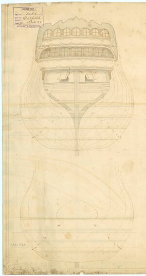

Start with the original body plan drawing

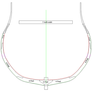

Typical frame drawing - Note that there were paired frames, 4 forward and 4 aft, to be placed at station 4 thus the ID on the drawing below

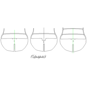

If POB --- Typical bulkhead drawing showing station number

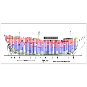

Framing disposition showing frame locations and station lines
Drawing for POB showing station lines would be much simpler and used for locating the bulkheads on the keel
