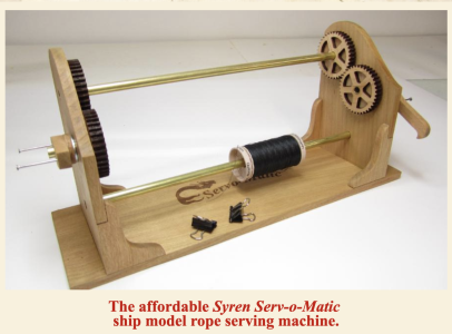

It's probably too late and an American supplier might lead to big shipping costs, but here's an excellent serving machine as well and good value for the money.
It's made of cherry of good thickness. It doesn't have a motor like I beleive the Domonov one does, but that's helpful if you want to get the wraps right. It works well enough that even I can get some decently served line and blocks. His commerce side of the website seems to be down now, but it's worth keeping an eye on.
The only parts that you can’t make yourself are the gears although 3-D printers can make these too. A whole bag full of plastic gears are inexpensive from on-line vendors. Alligator clips, also inexpensive can hold the line being served. I personally find that the gadget works better if the serving thread is held and tensioned by hand. Motorized? No thanks.

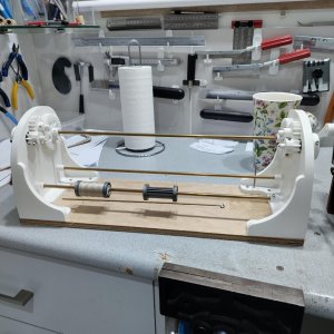

Hi Andy.
I looked at this and thought it looked crappy. I did find the files in the attached zip files below though. I went to my local library with them and had them printed, bought some bearings, and brass tube constructed this. A project in itself. I did add a 3rd idler gear so the rotation was in the same direction as the hand crank. Obviously if you only go with a gear and pinion (2 gears) the rotation is opposite to what your hand is doing, so for the extra few quid go with 3 gear train. I’m guessing all up it was probably double the price of what the ply version would cost but at least mine looks the part. I believe it could be easily adapted to be motorised, but I’m not doing industrial work.
