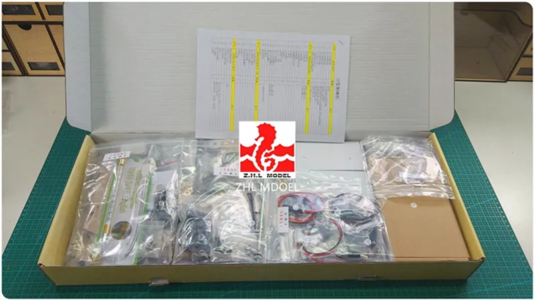

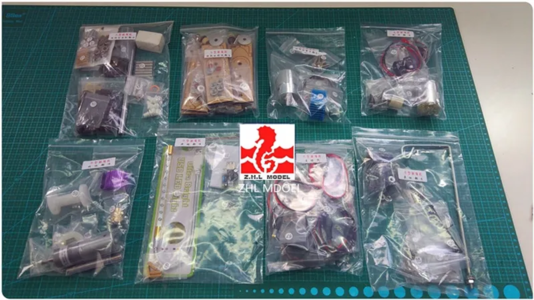

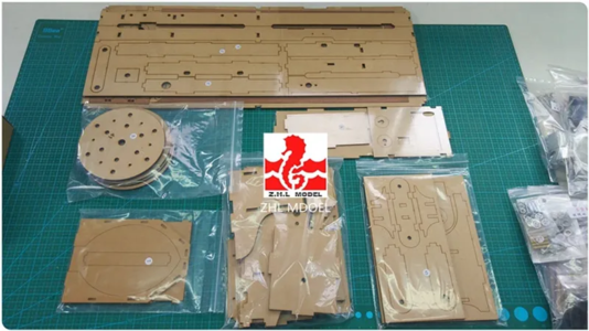

sure. no problem. Please see below for some pictures from ZHL of the open box. It is exactly like what I saw in my kit.
As shown, the kit looks like a challenge to put together, and I think it will be. The instructions are in Chinese but contain a lot of pictures, so I am hoping that I'll be able to do this build just based on the pictures.
What I am not sure about yet is whether stuff will be glued together or nailed together or maybe a combination of both. The instructions don't really clarify that. Well maybe they do, but I don't read Chinese.
More to follow...
More to follow...
All parts were labelled and easy to find.
No parts were missing, except for a single grub screw. Fortunately I had an extra one.
I couldn't really inventory parts at the beginning because the parts descriptions were in Chinese so I only found out if I had the part or not as I was building them machine.
