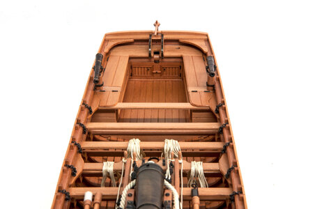

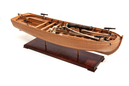

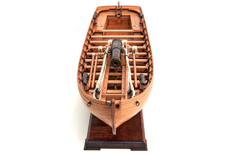

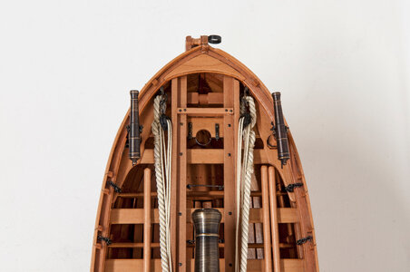

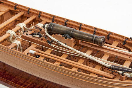

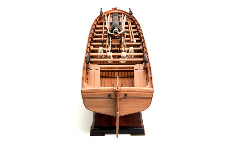

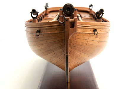

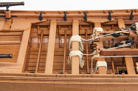

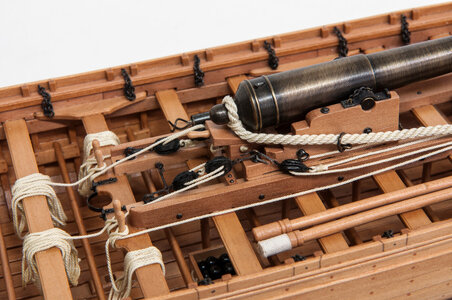

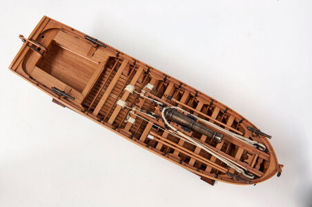

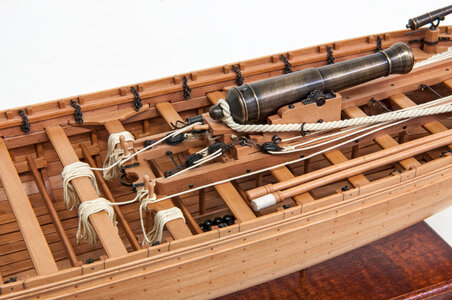

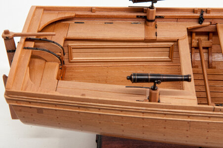

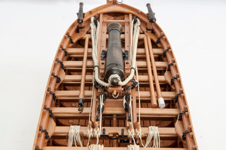

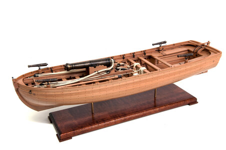

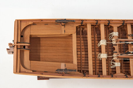

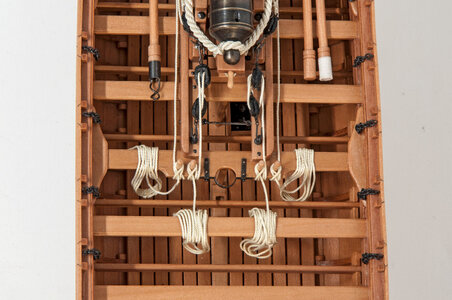

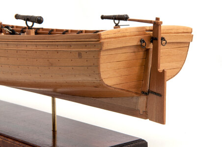

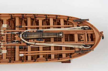

Hello everyone,
This model was built in 2013 in about 6 weeks at a scale of 1:36.
Text A.N.C.R.E
Besides their service usage aboard ships, longboats were also used for more warlike tasks. They could be used for the protection of harbor entrances or roads, as well as support for landings in enemy territory. In this case, the longboat was then referred to as an armed longboat. For such occasions, it was modified temporarily by installing a forward-firing chase gun atop the thowarts. This gun was guided by a system of slides bolted to the thwarts. It was not a “gunboat”, which was a well-defined, larger and often decked boat-type, but a regular ship’s boat armed with a large-caliber cannon.
The longboat described here is 13.00 meters long., 3.49 meters wide under the planking and 1.40 meters depth-in-hold. The plates with comments are from a plan dated 1834 of the Atlas de Génie Maritime.
