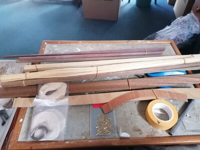

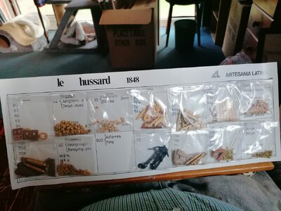

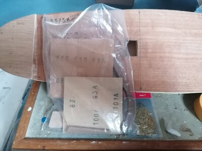

So it's time to see how i get on with it most of the planking has been done a few other bits to put right one was the deck piece on the stern was attached wrong so I have put that right.

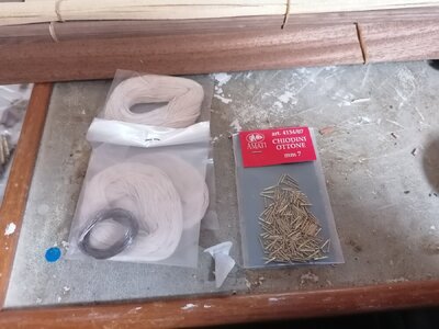

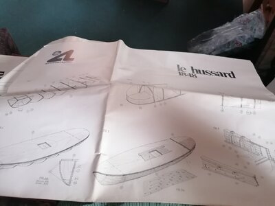

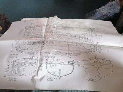

Time to show what I got to play with. IMG_20240727_190541.jpgIMG_20240727_190649.jpgIMG_20240727_190623.jpgIMG_20240727_190721.jpgIMG_20240727_190746.jpgIMG_20240727_190808.jpgIMG_20240727_190828.jpgIMG_20240727_190952.jpgIMG_20240727_190836.jpg

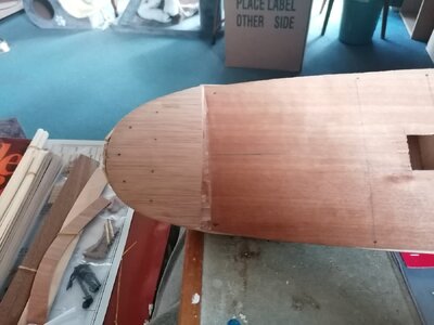

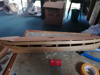

One of the first jobs to do is finishing off the planking only two each side and I found out that the previous builder only nailed the planks on but that's OK as there will be a second layer that will cover them over IMG_20240729_084108.jpgIMG_20240729_084057.jpg
